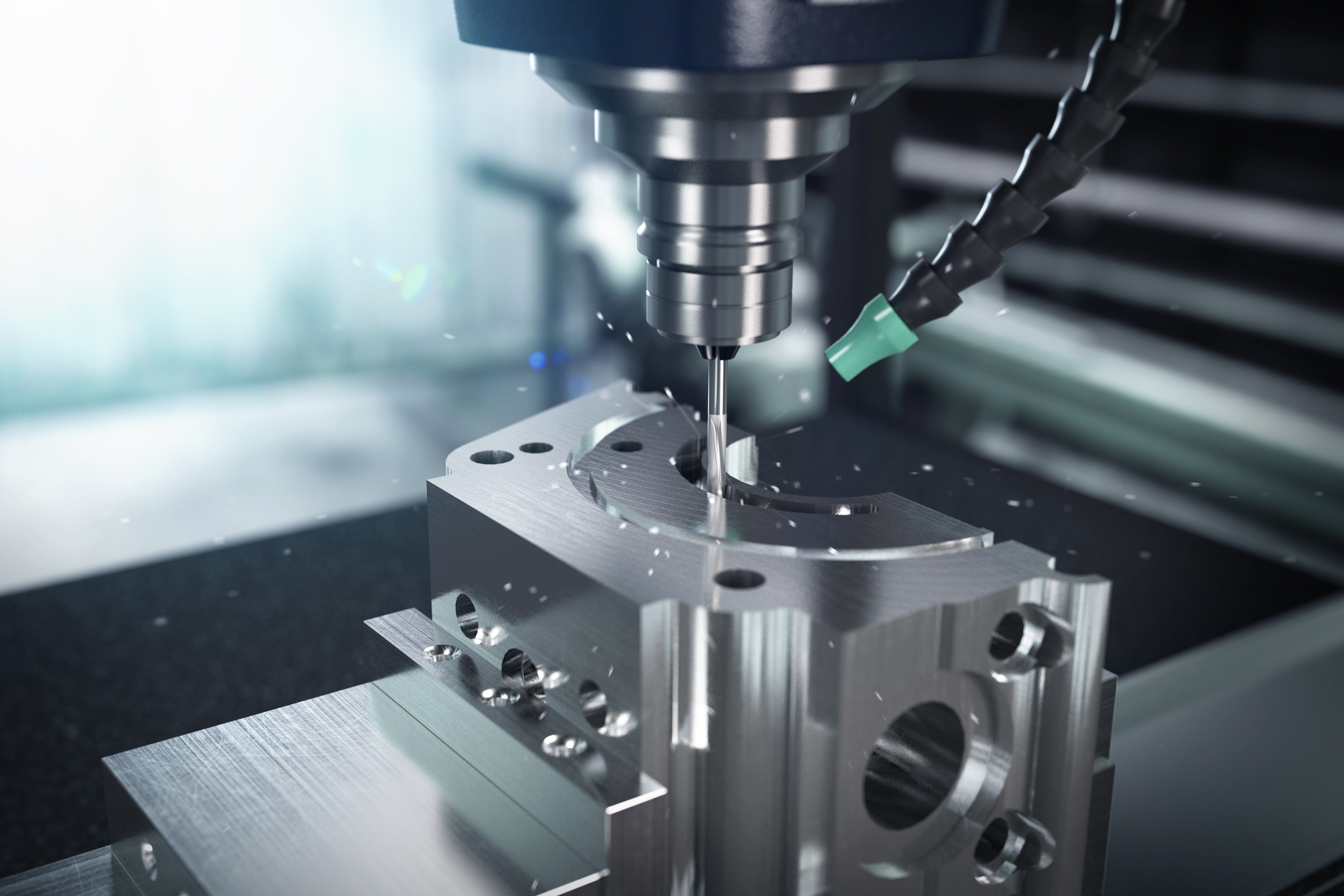

Aluminum is light, clean and easily machined, which is why machinists enjoy working with it. Aluminum alloys arrive without scale, dirt and oils because aluminum manufacturing processes are cleaner than those for other materials. Aluminum is also one of the least dense materials commonly used for manufacturing, making the metal easy to handle. Most importantly, it is a ductile material, which makes fabrication and machining processes uncomplicated.
People sometimes ask, “How fast can you machine aluminum?” The answer is as fast as a machine will run. Because aluminum is easy to machine, there is a broad range of effective cutting speeds. Aluminum is very forgiving and can be machined successfully using a wide extent of cutting parameters. The merciful nature of aluminum makes it an ideal material for training students, proving out new CNC programs and creating cool machine tool demonstrations at trade shows.

Development of machine tools, cutting tools and machining techniques specifically for aluminum has advanced quickly since the 1990s, and several machine tool builders have placed machines on the market expressly designed for machining aluminum. When paired with advanced cutting tools, the combination can create huge volumes of aluminum chips. If they are not removed from a work area, bad things might happen. Commonly known as re-cutting, chips can be drawn in by a cutting tool and become trapped between the tool and part, causing poor surface finish, tool breakage and increased tool wear. Manufacturers have employed high-pressure coolant to blast chips out of the cutting zone and applied high-volume flood systems to wash chips out of the machine. The volume of chips from these machines is so great that machine tool designs had to change so gravity could be used to help evacuate chips. Some vertical lathes have been reversed so their chucks are above the cutting tools, forcing chips to fall away from parts.
Aluminum also has a propensity for chip welding, or adhering to the edge of a cutting tool. Chip welding alters tool geometry, which exacerbates the welding problem and creates a chain reaction that typically results in tool failure. A fuzzy or melted-looking surface finish is the primary indicator of chip welding. Well-formed aluminum chips should be very shiny and smooth on one side and have a frosted appearance on the other. This indicates that chips are sliding across the face of the tool uninhibited. If a chip is fuzzy and white on both sides, chip welding likely has occurred. Correct cutting speeds, suitable coolant, properly prepared cutting tools and good process development are needed to combat chip welding.
