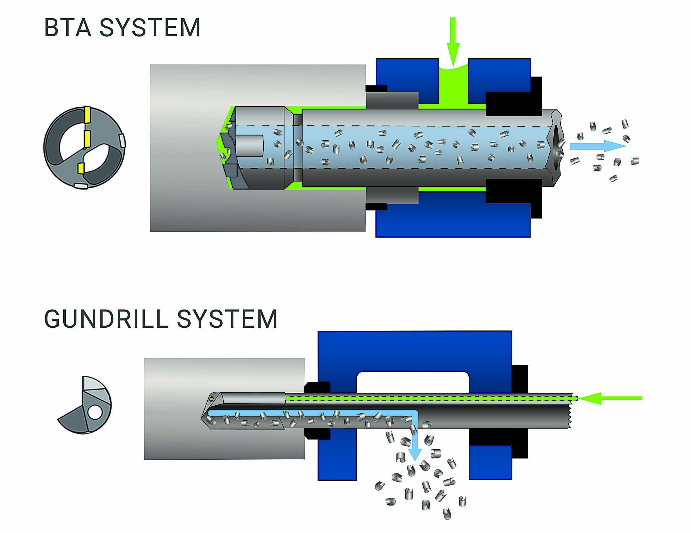

A true gundrill is a single-flute, self-piloting tool that also burnishes the hole that it generates. Unlike the spiral flutes of twist drills, the straight flute of a gundrill extends for the length of the drill, and through-tool coolant reaches the cutting zone via an outlet at the drill tip. High-pressure coolant then pushes chips up the bore, along the straight flute and out of the hole.

For larger-diameter deep holes, BTA drilling is a highly effective process that gives great versatility and top quality. The Boring and Trepanning Association, an industry standard consortium of manufacturers, developed the BTA system in Europe over 80 years ago. The process employs a specialized drilling head mounted on a long drill tube, and machine tools designed to perform BTA and related processes are complex systems of high-precision components engineered to produce extremely deep, highly accurate holes.
Compared with gundrilling, in which through-tool coolant is introduced at the cutting zone and forces chips out through the drilled bore, the BTA system essentially operates in reverse. In BTA drilling, coolant is fed outside the drill tube through the drilled bore to the cutting zone. Chips then are evacuated through the center of the drill, eliminating the chance that they will scar the drilled bore surface. BTA application diameters generally start at 1", but use is more common at diameters greater than that, and the process shows benefits in 20" and larger bores.

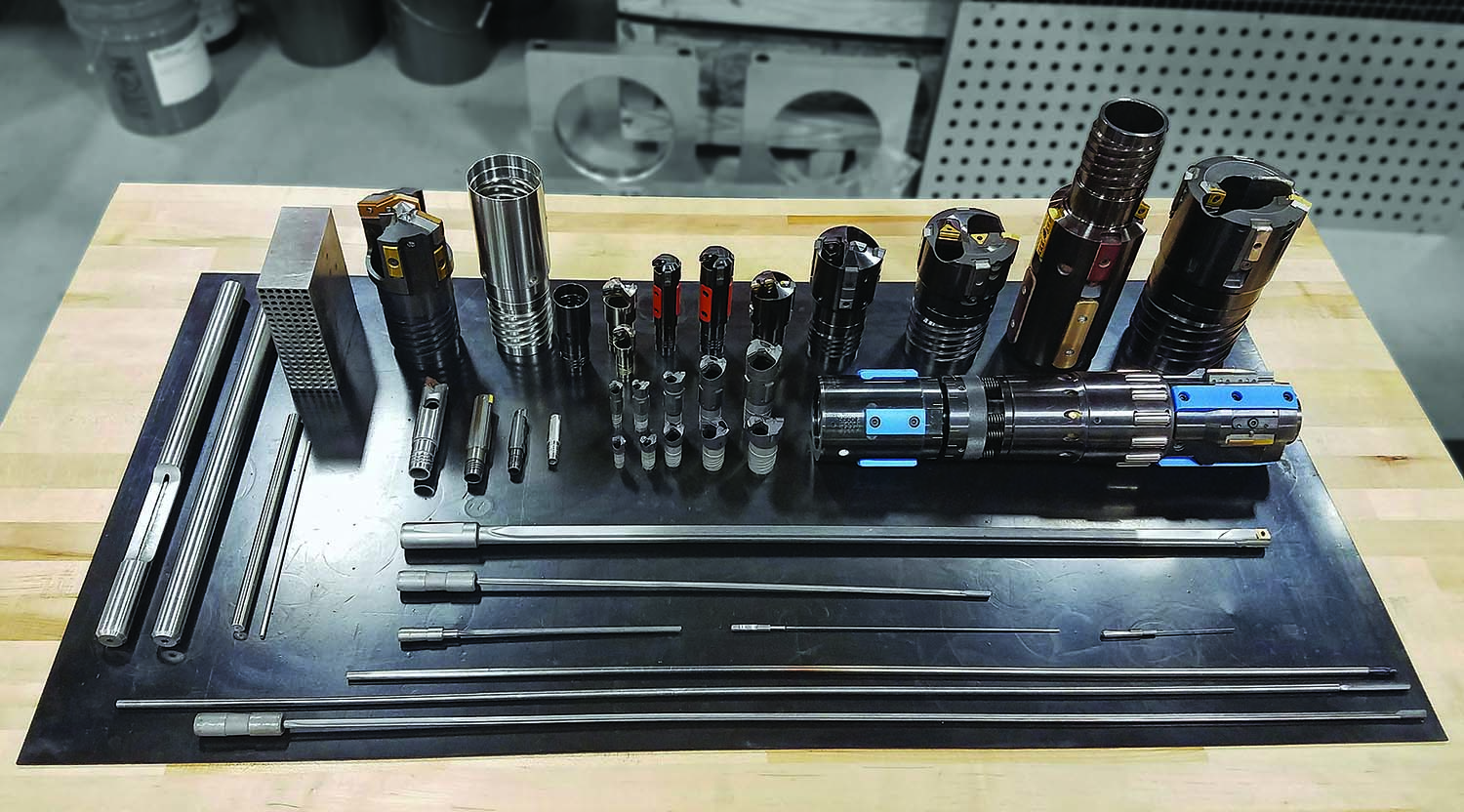

Considering their versatility in creating a wide variety of hole sizes and geometries, BTA drill systems actually provide deep-hole machining, as well as deep-hole drilling. Complex hole configurations, such as step bores or internal contours, can be produced by sequentially revisiting a bore with different tools in the same machine and in the same setup. Typical operational steps might include drilling through a workpiece, straightening the bore via pull boring, counterboring to create a larger bore on the same centerline and then using a radius tool on the hole bottom and skiving or burnishing tools to achieve a superior hole finish.

Ongoing improvements in deep-hole drilling tooling include tip geometries, coatings and carbide technologies that permit greater penetration rates and thereby higher throughput. Some tooling also may require new drilling machine technology to fully exploit the productivity advantages of those new tools. The combination of technologies results in greater productivity, as well as increasingly cost-efficient operation.
