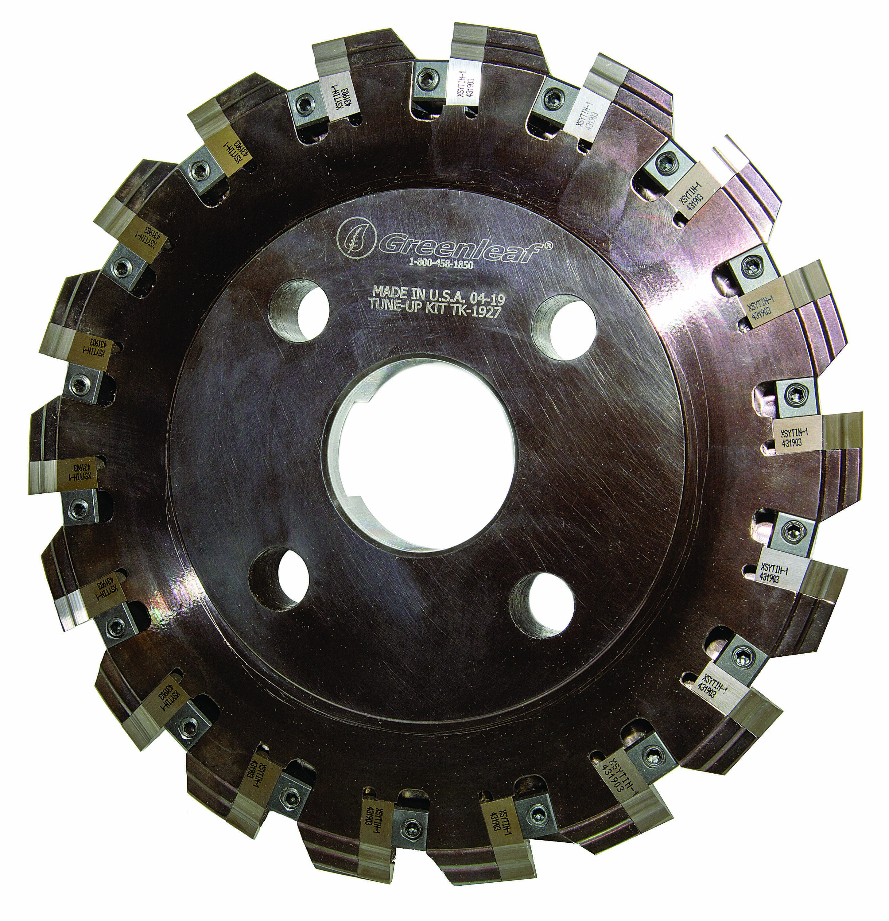

Bronson said Greenleaf designs cutters that go into curved shapes, “which is a challenge because you don’t have a straight line of sight through that slot like you would with traditional slotting. The tool is a little unusual. When you look at the side profile of a contact lens, it’s dished; that’s the shape of the cutter.”
Unlike most cutting tool manufacturers, he said 60% to 70% of the tools Greenleaf sells for slot milling are specials because the standard line from the company is fairly narrow.
“We do a lot of custom work for customers based on what their specific part needs are,” Bronson said.
For example, the toolmaker has produced slot mills with diameters as large as 660.4 mm (26").

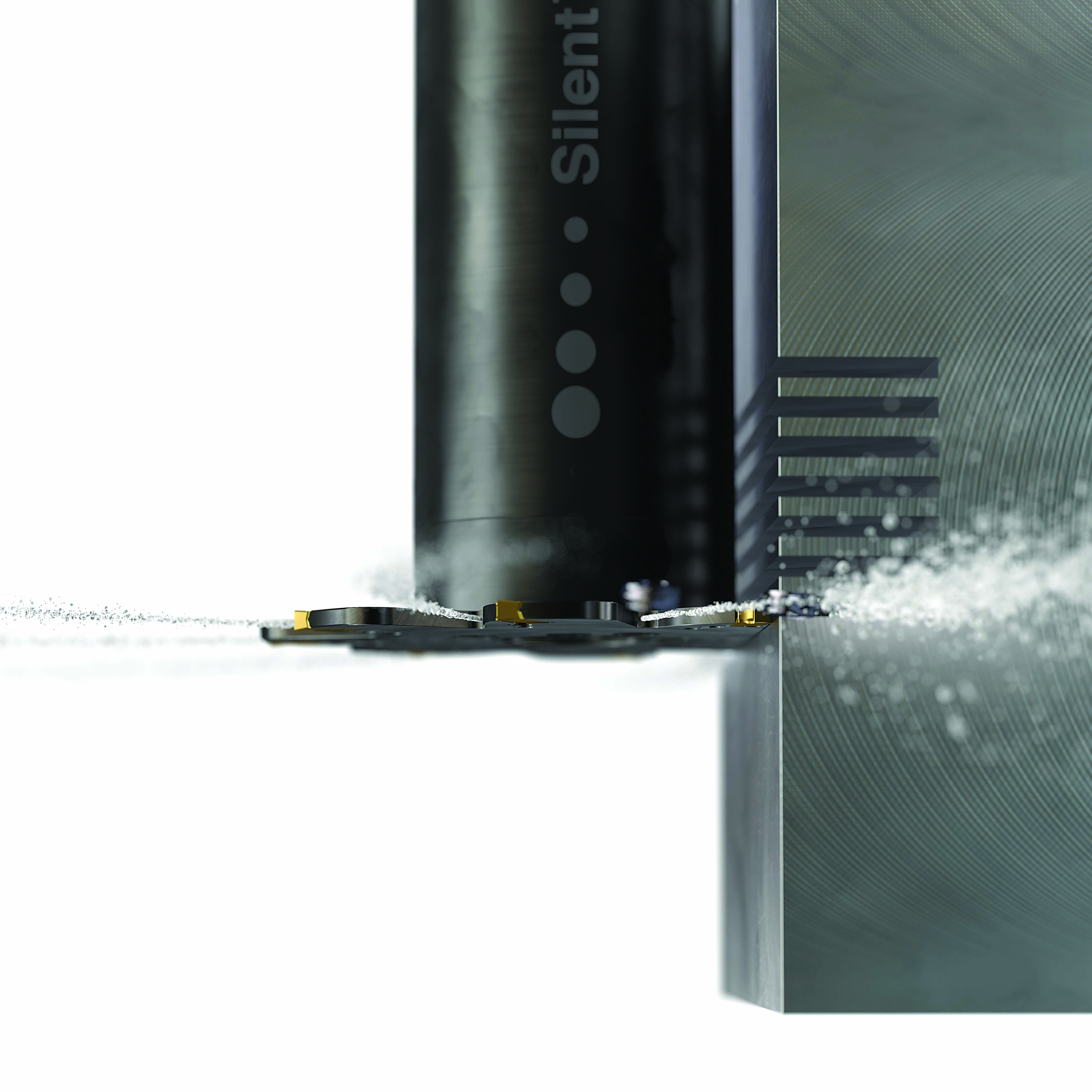

Indexable-insert wheel cutters with internal coolant, such as the CoroMill QD tool, are effective for groove milling. Image courtesy Sandvik Coromant
Tucker said that about a year ago Sandvik Coromant introduced Inveio coating technology, which further improves the ability to prevent cracks from forming on the edge line.
“It has a columnar structure,” he said. “The better those columnar structures are aligned, the better the ability to stop crack propagation in the milling process.”

Although Tucker typically recommends high-pressure, through-tool coolant, he said too much coolant pressure in a cutter creates vibration, especially when slotting or grooving aluminum at high speeds and feeds.
“You can get a vortex situation inside a groove where the pressure is so great that the cutter starts vibrating,” he said. “There is a fine line there, but it’s usually a condition of how fast you are spinning that cutter.”
Bronson said flood coolant is more beneficial than high-pressure coolant when slotting to control the temperature of a part and keeps its dimensional criteria stable.
“It’s very unusual for us to see 1,000-to-1,500-psi applications in indexable slotting,” he said.
Using an air blast or chilled air is another option for keeping a part and tool cool when slotting. Bronson said an air blast or chilled air is recommended for slotting with ceramic inserts, which Greenleaf has a long tradition of producing. Air cools a part and tool and helps remove chips from a toolpath, extending tool life. In addition to uncoated ceramic inserts, the toolmaker offers coated ones, which resist heat, can increase lubricity and add a thermal layer to prevent chemical erosion when machining.

An example of a slotting cutter is shown. Image courtesy of Greenleaf
“You are a little bit limited in the number of teeth you can use because you need more flute space,” he said, “so the material that you are removing has to fit into that flute space and be evacuated.”
Pollock said another limitation is the feed per tooth and cutting speed that the tool can run at based on the rigidity of the machine and how much force the tool can withstand before fracturing.
