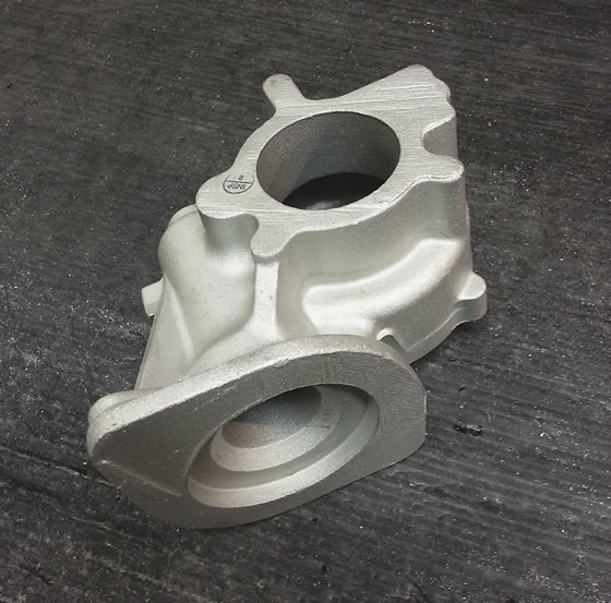

Before (above) and after (below) photos of a starter housing component that Southland CNC accepted after seven other machine shops refused the job. This job requires applying seven boring heads, ranging from 0.314" to 4.287" (7.98mm to 108.89mm) in diameter.
Issues with supplied boring heads entailed frequent readjustments, a task too time-consuming for a single operator to perform.

Perhaps the most telling anecdote Parks recalled about BIG Kaiser tooling is when a new customer came to Southland CNC with an extraordinarily difficult part to machine. The customer had previously visited seven other machine shops and none of them felt they could process the starter housing component. “They told us if we couldn’t do it to print, they were going to scrap the project,” Parks said.
After setting up the tooling fixtures with seven boring heads, Southland CNC was able to finish the part better than the blueprint’s specifications, Parks said. “We did it right out of the gate without a second try.” Southland CNC still produces the part, and can make about 40 of them per day.
