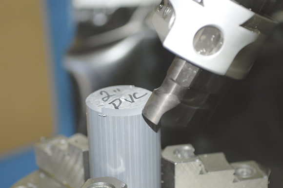

When working with a convex surface, the cutting edge faces inward.
Imagine a cutting tool that only cuts a hollow circle, kind of like a hole saw. When the tool is set at an angle other than the axis of the rotary table and the part is rotated under the tool, a spherical surface is generated.
The boring head is tipped at an angle that represents the chord of the desired spherical segment. A single-point cutting tool is applied and, depending on whether the form is concave or convex, the cutting edge is reversed. For convex surfaces, the cutting edge faces inward. For concave surfaces, the cutting edge faces outward, as it would in normal boring head work.
As the tool is advanced into the workpiece, the rotary table is rotated through 360°. The rotary table is also fed into the tool along the X-axis.
When you first try this method, use plastic so you can quickly see exactly what is happening before you try it on important parts. There are three variables you must understand to get controllable results. The first involves basic calculations. The second is the setup and the third is the execution—actually doing it.

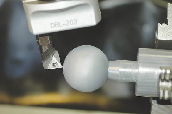

When working with a concave surface, the cutting edge faces outward as it would in normal boring head work.
The spherical surface generation technique can produce a full sphere.
A single-point cutting tool sweeps through a circle that has no thickness on one side of the cutting edge. If you think about how a ring of any size smaller than the spherical surface can lay in full contact with the sphere, you can visualize how the cutting action takes place.
The material that projects into the ring is cut as the part rotates under the cutting tool. This leaves a spherical surface the size of the ring. Any plane that cuts through a sphere produces a true circle, no matter what the angle.
In the hemisphere illustration, we can see the basic graphical setup for cutting a full hemisphere 2 " in diameter. The chord in this case is 1.414 ". This is the diameter the boring head would be set at (1.414 ") or a little larger to cut the 2 " diameter. The spindle would be tilted 45° relative to the rotary table axis to cut a full hemisphere. You can see from the drawing that no other angle would produce a full hemisphere. This axis of the spindle must be perpendicular to the segment chord. The spindle centerline is the midpoint of the chord. The chord is also the hypotenuse of the right triangle, which is the maximum rise of the radius and the distance from the centerline to the endpoint of the arc.
For other radii and partial segments, a little math is required to get the chord and the angle. We can use our drawing example to illustrate the math. There is no official name for the diameter the boring head is set to, so I call it the “swept diameter” (SD). For OD work, the SD should be set at the chord size or larger. For ID work, the SD should be set smaller or the same as the chord.
Angles less than 45° produce less than a full hemisphere. Angles greater than 45° produce greater and greater portions of the sphere until you reach a maximum of 180° for a full sphere. Once you go past 45°, the boring head must be set accurately to the chord length before you reach the finish diameter. You can adjust this as you rough the part, taking measurements as you go.
In actual practice, you can’t cut a full sphere in one setup. You still have to hold the part and rotate it somehow. To produce a full sphere, you must use two separate holding setups. CTE
