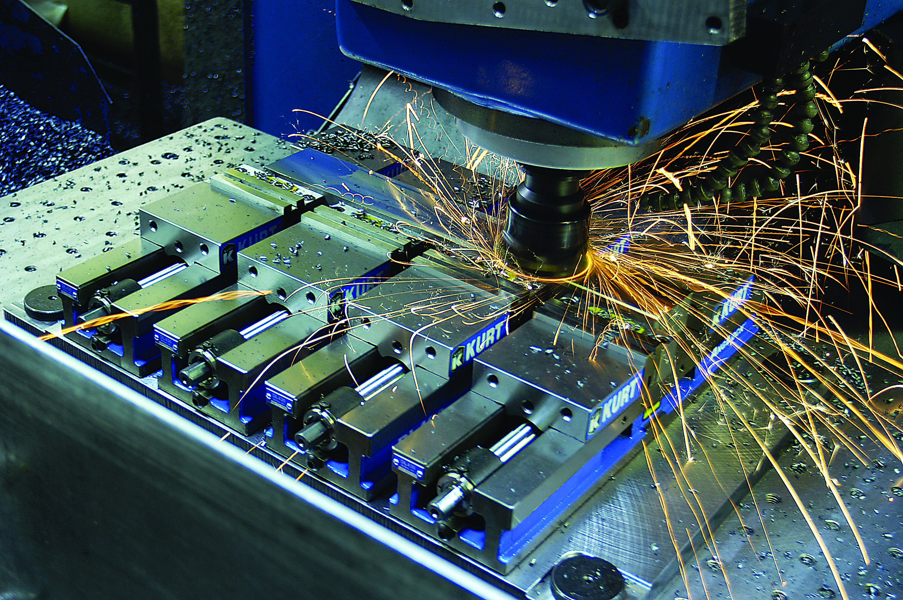

Of all the workholding methods, the machinist vise continues to be the most popular. Photo credit: Kurt Industrial Products
Image courtesy of Kurt Industrial Products
Of all the workholding methods available to machine operators, the machinist vise continues to be the most popular. It’s easy to use, flexible and readily accessible with a price tag that all but the most cash-strapped of shops find agreeable. Getting the most out of a vise, however, requires a little tender, loving care, as well as the ability to think creatively.

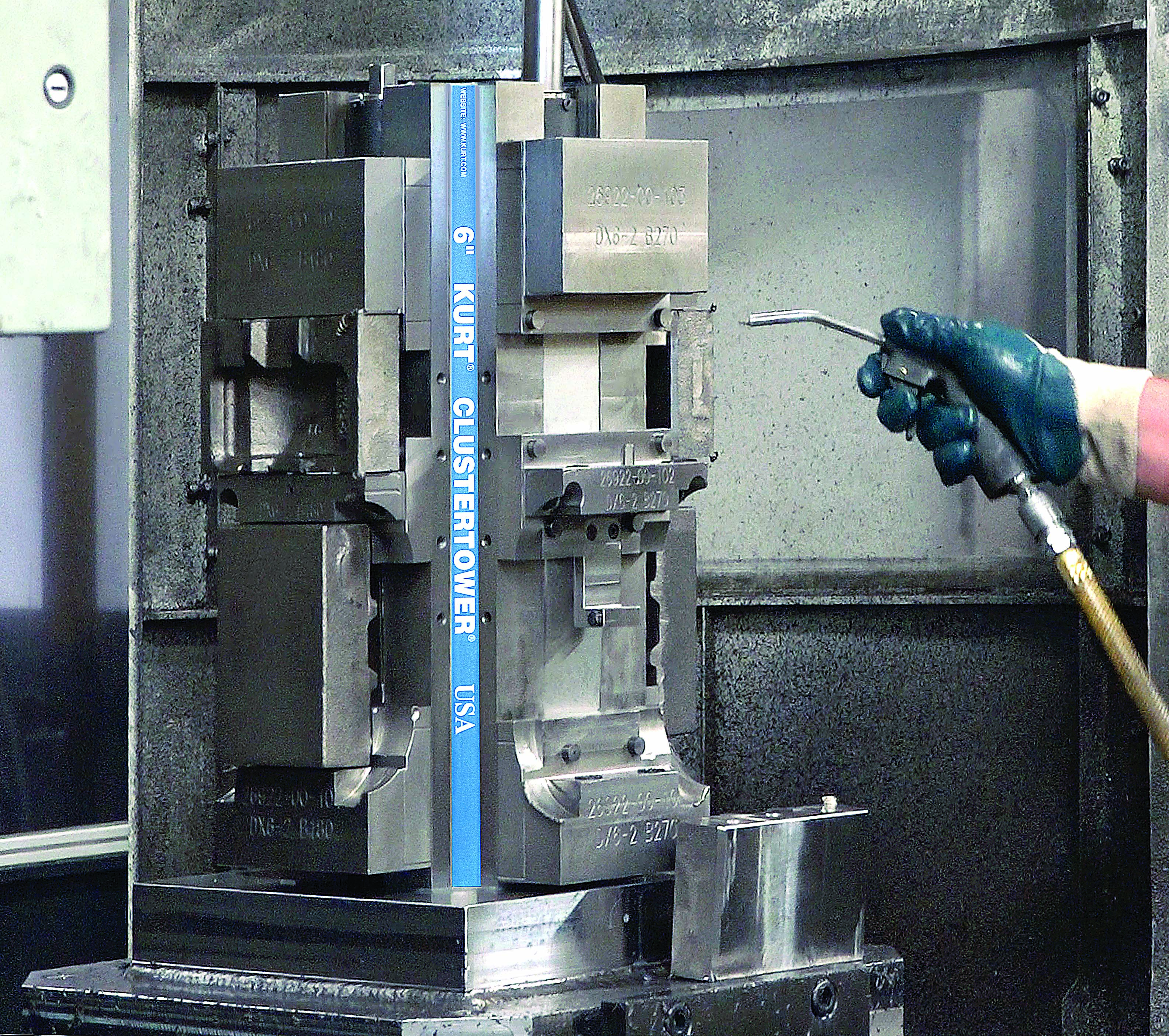

The TLC part is easy. Steve Kane, sales and marketing manager at Kurt Industrial Products, Minneapolis, said the first step is simply to keep vises clean.
“A lot of people make the mistake of not wiping the vise down and applying a coat of oil when they’re done using it,” he said. “Depending on what kind of coolant they’re using and its condition, this can lead to rust, especially if the vise gets placed on a shelf between jobs. They should also make sure there are no chips collecting inside. If so, blow them out with a little shop air.”
Aside from keeping a vise clean, Kane said to apply a small amount of marine grease to the screw threads once a month and then run the vise through its full travel to evenly disburse the grease. It’s also wise to remove scratches or dents with a fine stone.
Of course, shops must adjust their maintenance routines to the types of materials being machined and the amount of use a vise gets. Shops that routinely cut cast iron and other abrasive materials, for example, should watch for wear. Machinists might want to more often clean and lubricate internal components and even periodically break down a vise to avoid damage, as long as they know how to properly reassemble the vise.

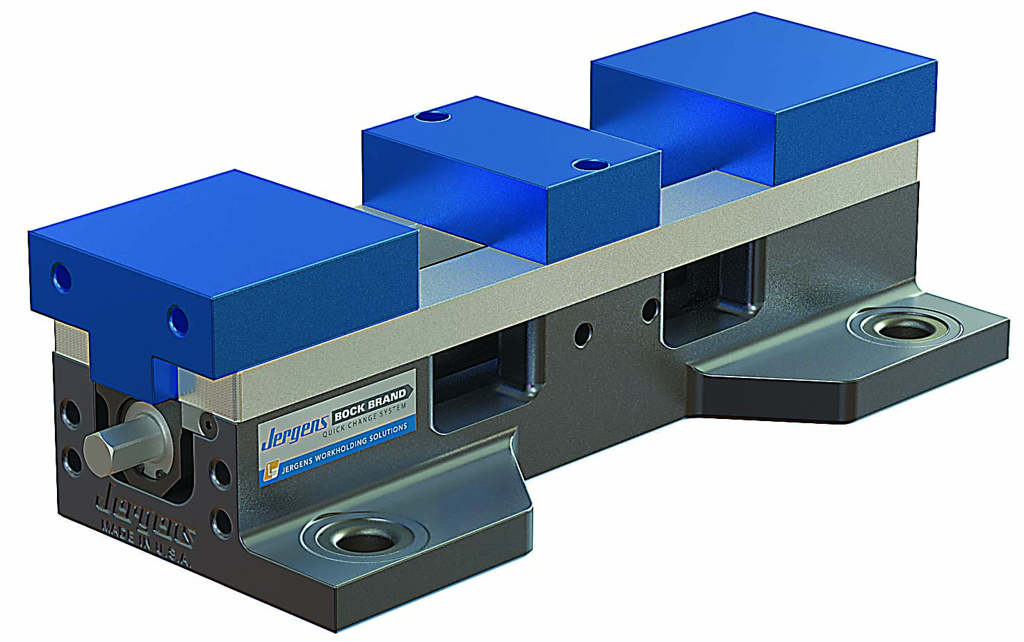

There’s also real estate to consider. For the best use of available table space, consider a double-station vise. Whether called a Production Vise (Jergens), a DoubleLock or an HDL Vise (Kurt), double-station vises offer the ability to machine twice as many parts per machine cycle versus single-station counterparts, with a footprint that’s only marginally larger.
