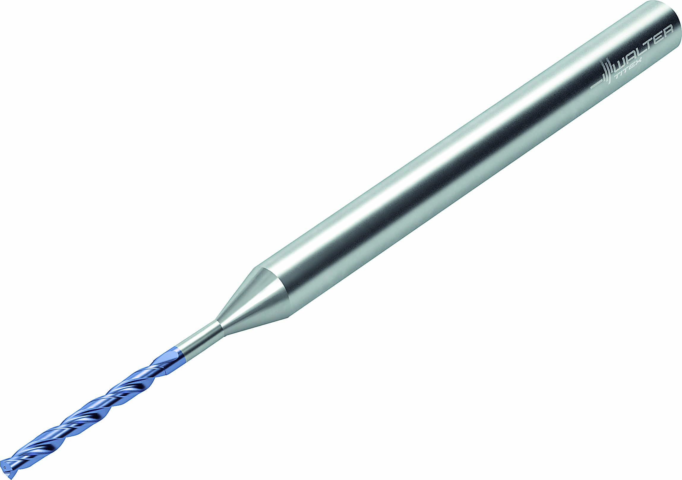

Garud said Walter USA’s leading designs of microdrills have coated flutes to provide a secure, reliable way to evacuate chips. In general, that capability also can be achieved with smooth or polished flutes.
The DB133 microdrill features through-coolant capability. Image courtesy of Walter USA
“Reducing the cutting forces and secure chip evacuation (are) even more important (for microdrills) than conventional drills,” he said, “due to their small size and inherent weakness in the drill body with such a small diameter.”
