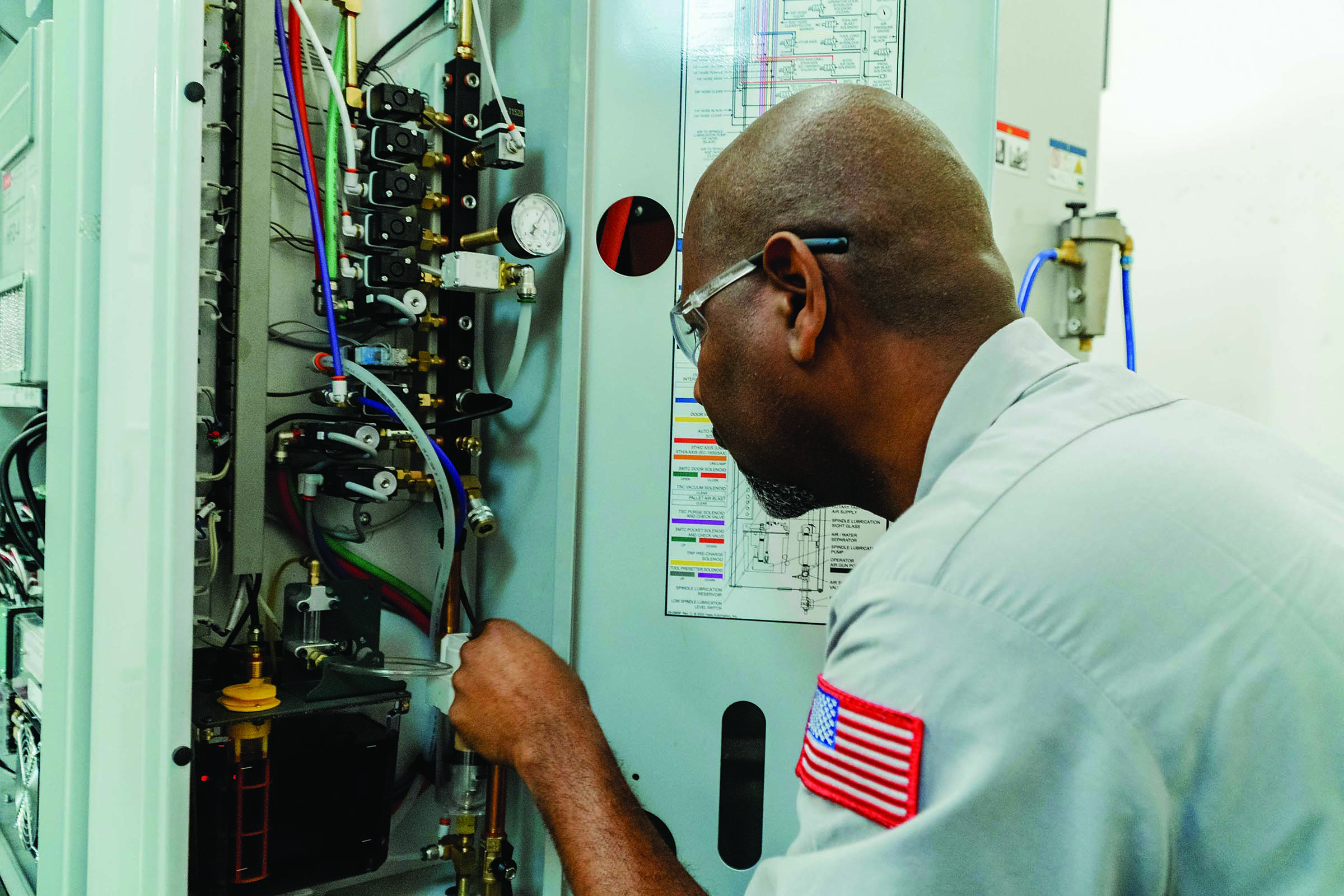

![Service Engineer Orville Collins (top photo) checks the oil level for a machine spindle.](/sites/default/files/inline-images/Image%204%20DSC09999_0.jpg)
Today, those wishing to stay on top of machine maintenance are aided by a variety of tools and technologies aimed at making the job easier. For example, most machines now are equipped with sensors that trigger an alarm if the grease or oil level is low, said Orville Collins, service engineer at Haas Automation. But he advises not letting things get to that point. The reason is that the alarm could come at a bad time — say, when the machine is in the middle of cutting a mold.
If that happens, “chances are you could end up damaging that mold,” he said.

To keep things running as they should, there’s no way around regular maintenance procedures. Collins recommends that a number of them be performed first thing every morning, including making sure that machine spindles are warmed up properly, air lines are cleaned out and the coolant level, pressure and concentration are correct.
In addition, O’Fallon stresses the importance of flushing chips out of machines. If this isn’t done, he said chips will get into all sorts of places they shouldn’t and cause damage and rusting.
“So I would say the single most important thing to do is to clean the machine at the end of the day,” he said.
As for less frequent maintenance, fluid lubrication — grease for the ways and oil for the spindle — should be checked at least monthly.
“If you run out of oil for the spindle, you can burn up the bearings and kill the spindle,” O’Fallon said. “If you run out of grease for the ways, you can (damage) linear guides and ballscrews, which are very expensive.”
