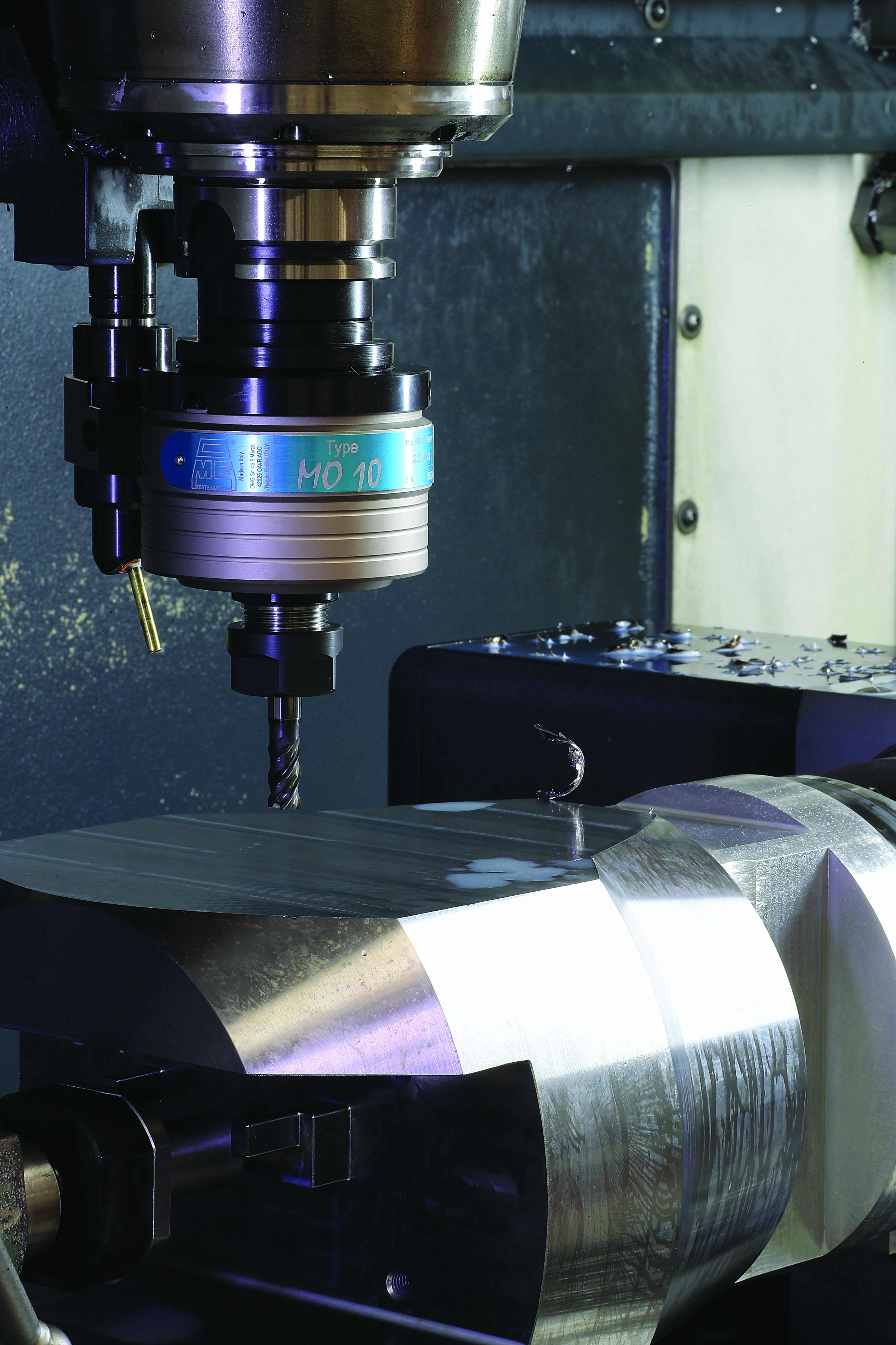

The MO spindle speeder for micromachining applications can increase spindle speeds to 35,000 rpm. Image courtesy of OMG North America

“When machining material like aluminum, the tool manufacturers might recommend a surface speed as high as 350 sfm (106.68 m/min.), and if you wanted to run a 1 mm (0.039") carbide drill, you would need 35,000 rpm to reach that surface speed recommendation,” said Mark Johnson, manager of OMG North America, Post Falls, Idaho.
The company offers the MO series of spindle speeders, including the MO10.HS for micromachining applications with a maximum output speed of 35,000 rpm.

Having good concentricity is important when running at high spindle speeds, Johnson said.
“Anytime you add another element between the cutting tool and the machine spindle, there’s the possibility to have a greater amount of runout,” he said. “The spindle speeders that we produce have a high accuracy between the machine spindle taper and the output spindle of the speeder. The maximum runout allowance is just 1 µm, or 0.000039". Often the resulting runout is significantly less.”

Mechanical spindle speeders include those made by OMG North America.

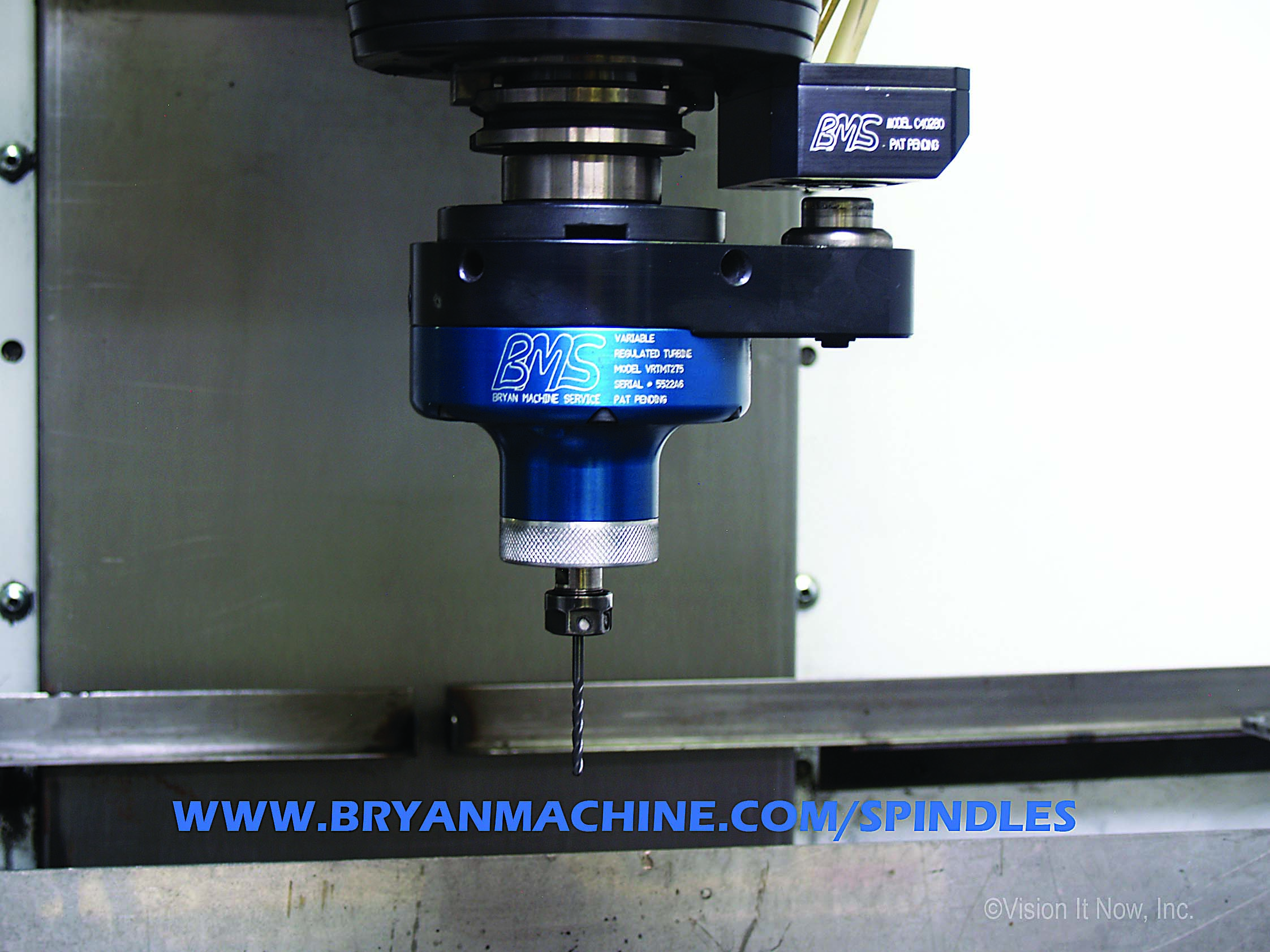

VRT spindle speeders have a built-in regulator that adjusts pressure to provide the right amount of power. Image courtesy of Bryan Machine Service
These tried-and-true devices are built with high-quality bearings and gears, so they have a “very positive drive-through gearing and a very rugged construction,” Johnson said.
The highest-speed models feature two planetary gears with ratios of 1-8 for high transmission and high power ratings. The speeders are available with shanks for all machine spindles and have the option of through-tool coolant to be supplied through a machine spindle. A spindle is supported by a set of pre-loaded ball bearings with oblique contact that ensure strength and rotation precision of less than 0.01 mm (0.0004").
Bryan Machine Service’s VRT high-speed spindles have variable-speed adjustment and utilize air turbines, which do the actual turning instead of the machine spindle. The spindles feature an adjustable built-in regulator to maintain spindle speed as the cutting load varies.
“As the cut gets heavier,” Bryan said, “then it supplies itself with more air to adjust to the load.”
Operators adjust spring tension internally on the regulator via a button on the side of the spindle.
The unit also features an autocoupler that originally was designed for a Haas vertical machining center. The coupler is adaptable to most CNC machines, including lathes and grinders. When not in use, it is closed on each side to seal it from debris. An air wash feature blows away coolant before it can enter the spindle during the coupling.
“Any tool-changeable spindle gets a slight bit of coolant in it every time it couples, even if it is one drop,” Bryan said. “After thousands of cycles, it gets to be a problem eventually. This helps solve that problem.”

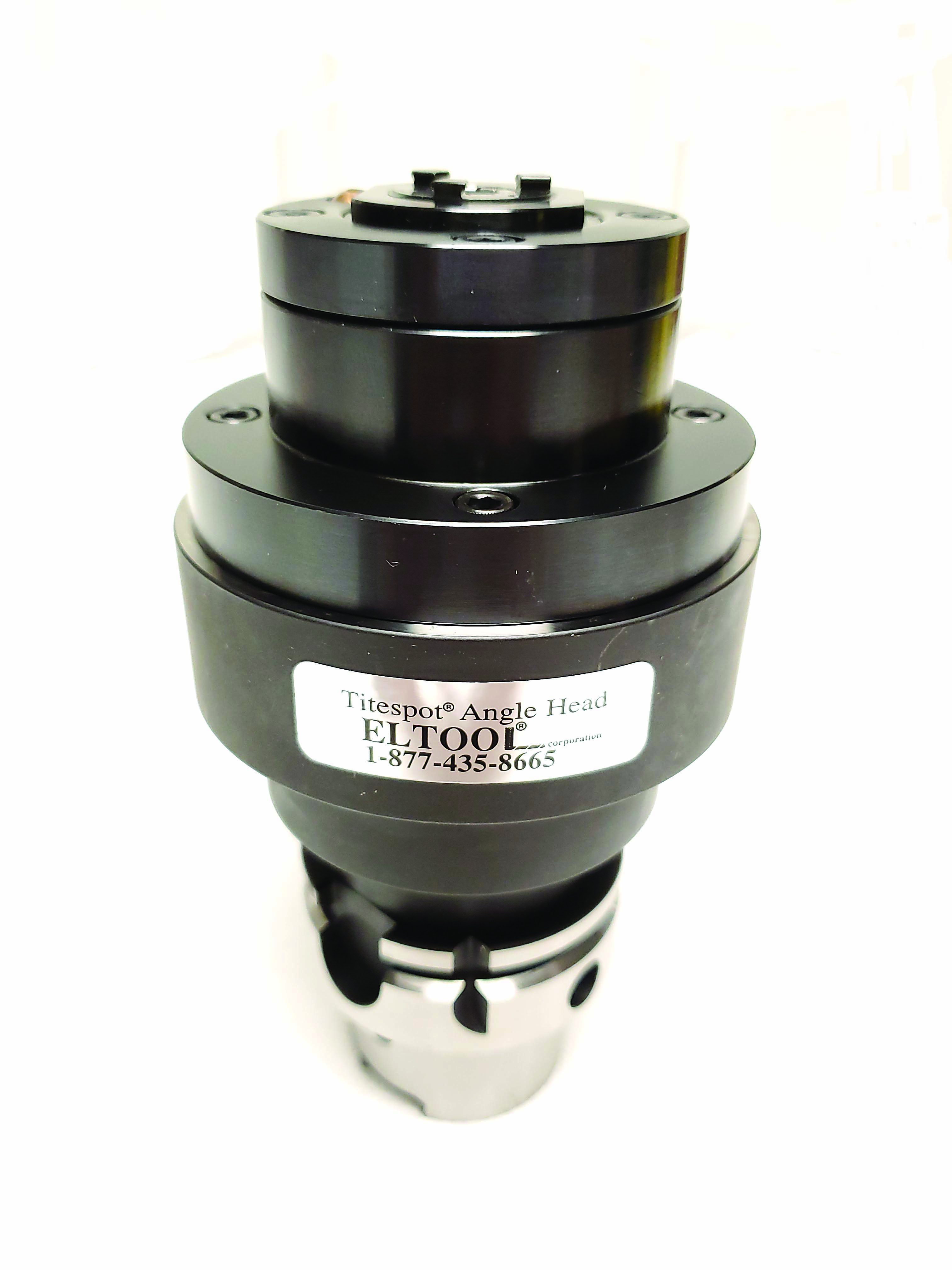

Eltool’s Titespot spindle speeders are powered by a positive displacement ball piston motor. Coupled to a high-pressure coolant system, this results in machining center spindle speeds of as much as 45,000 rpm.
Titespot speeders, which are available in common taper sizes, operate at 13.8 to 137.9 bar (200 to 2,000 psi) depending on the load. The standard speeder delivers 900 rpm per 3.8 liters (1 gal.) of coolant flow. With a 37.9-lpm (10-gpm) coolant delivery system, this equates to 9,000 rpm. But with the addition of a modular 1-5 planetary gearbox, spindle speed increases to 4,500 rpm per 3.8 liters of coolant flow. So the same 37.9-lpm system now delivers 45,000 rpm.
“The power has not changed,” Young said. “We just generated more speed by shifting into fourth gear.”
The speeders also can be adapted to lathes and are available in-line or as right-angle heads.
