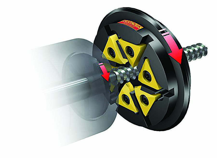

Most thread mills, solid carbide or inserted, are multitooth tools. The teeth are arranged parallel, rather than helically like a tap. Multitooth thread mills cut the full depth of the thread in a single rotation around the hole.
Courtesy of J.M. Sales
J.M. Sales offers its Quattro indexable-insert thread mill (left), GFT thread mill with three rings of teeth for small diameters and 3 diameters deep (second from left), BGFS-W drill/thread mill for steels and titanium (second from right) and BGFS-H drill/thread mill for hardened steels (right).
One multitooth thread mill can cut threads of the same pitch in a range of diameters. This is because the diameter is determined by the CNC toolpath instead of the tool (as with a tap). “With a fixed pitch, the multiform tool can cut any 20-pitch thread, whether it is ¼-20, ¾-20 or 2"-20, as long as it can fit in the hole,” said Stephan Francescone, production manager for Harvey Tool Co. LLC, Rowley, Mass., which makes single- and multiple-form solid-carbide thread mills.
“The multiform thread mill is fast because all those peaks and valleys are cutting at the same time to create the thread,” said Jeff Davis, vice president of engineering for Harvey Tool. “The downside is that you’re locked into the pitch because of those peaks and valleys. Anytime you see more than one triangular thread form on a tool, you have a fixed-pitch situation.” Each thread pitch requires a different tool.
In addition to being able to cut any diameter, the advantage of a single-form thread mill is it can cut any thread pitch or a range of thread pitches. However, a single-form thread mill can only cut one thread in a single pass and must move around the hole as many times as there are numbers of threads.
“Even though they have to buy a thread mill for each pitch, larger production shops lean toward a multiform so they have a nice array of tools,” Davis said. “The single-form tools lend themselves more to smaller job shops that want a more flexible tool.”
