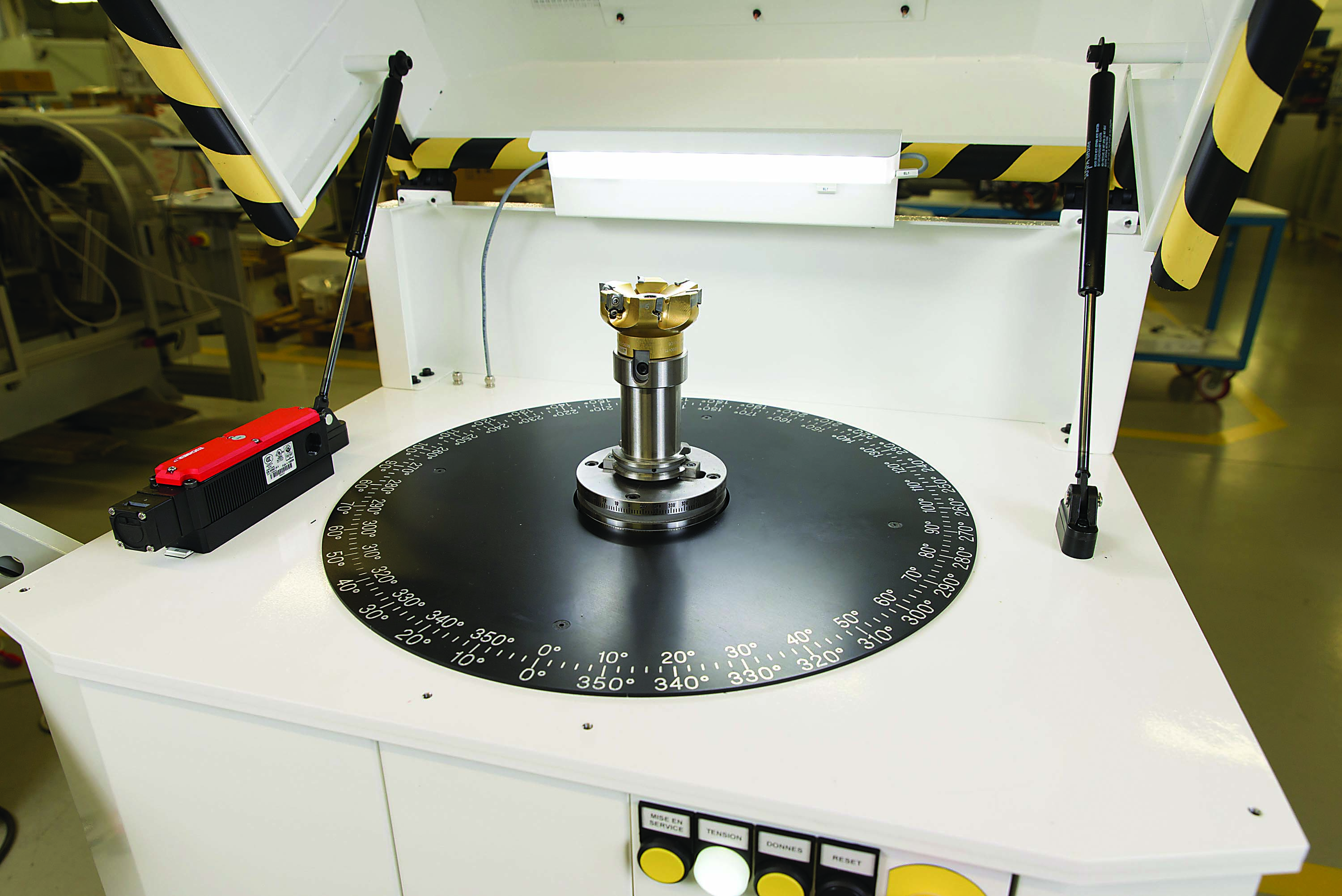

The Tool Dynamic TD Comfort balancing machine (above) is equipped with a PC, keyboard, mouse and monitor. Image courtesy of Haimer USA

Haimer USA’s most popular balancing machine is the Tool Dynamic TD Comfort, which Holden recommends based on its ease of use and accuracy.
“We use a spindle that clamps the tooling assembly as if held in the machine tool spindle, and the machine itself has a hard-bearing spindle that uses centrifugal force sensors to measure the unbalance of the tooling assembly,” he said. “The ease of use comes from the software that guides the user through an easy modification process.”
