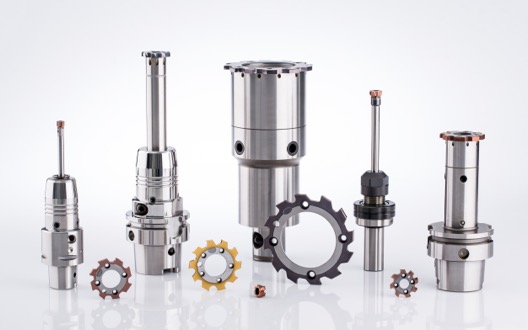

As with other tool systems, high-performance reaming systems are also subject to demanding requirements. In addition to high process reliability, long tool life and low tool costs, modern reaming tools must fulfil further criteria. These include, among other things, the modularity of the tools. While machining with an HSS reamer is partially limited in this respect, modern reaming systems can be improved by replaceable heads with carbide inserts, modular tool lengths and various adjustment options. These include, for example, µ-accurate adjustment of concentricity and runout. Precise concentricity of the reaming inserts is the path to success. In practice, this should be within 5 µm.

In addition to the precise grinding of the carbide insert, the appropriate tool geometry for the machining operation also plays an important role in economical reaming. Therefore, two insert orientations or side rake angles are used for reliable chip removal. Straight-insert reaming cutters are suitable for machining blind holes. Chip flow is in the opposite direction to the machining direction. Left-hand helical inserts are designed for reaming through holes only. In this case, the direction of chip flow and machining is the same.
Controlling chip breaking is an important aspect of successful boring. In deep bores, with low coolant pressure or dry machining, helical or ribbon swarf can occur. As with drilling with twist drills, the chips can be broken by briefly lifting the reamer. It is important to program as few interruptions as possible, but as many as necessary, as retractions can reduce the service life of the cutting edges. The lifting of the tool is hardly noticeable in the appearance of the machined surface.

With the newly developed DR-Large reaming system, Horn has extended its expertise in boring. The tool offers easy handling and high precision thanks to the proven technology of the DR tool family. The large number of cutting edges enables high cutting values and consequent time and cost savings in machining. The user achieves great flexibility thanks to the modular design and the solid carbide inserts of the tool system. There is no need for tool adjustment when changing the cutter head. The versatile and powerful interchangeable reamer system covers bore diameters from 140 mm to 200.2 mm. Horn offers servicing for simple and fast reconditioning of worn heads.
Basically, reaming is a very economical machining process. Compared to turning or milling bores to tight tolerances, reaming is many times faster and can significantly reduce unit costs. Horn has developed a high level of know-how for economical boring and has a powerful tool system in its range with the modular, high-performance DR reaming system. It covers bore diameters from 7.6 mm to 200.2 mm. All variants are equipped with internal coolant supply directly to each cutting edge. The insert interface offers high changeover accuracy to within a few µm and enables quick and uncomplicated insert exchange.
