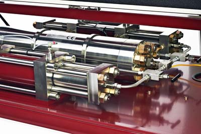

AccuStream has redesigned its popular AS Series intensifier pumps to maximize output, increase energy efficiency and offer more robust control. In an effort to contain rising production costs and maintain pricing for its customers, AccuStream simplified the design of the AS Series intensifier pumps while maintaining the hydraulic functionality and core technology that makes these pumps so successful.
Changes include a new true soft-starter that reduces the amount of electricity the pump consumes during startup. Because the soft-starter also minimizes spikes in energy consumption during normal operation, users should experience overall lower electricity costs.
AccuStream also improved the hydraulic circuit filtration with a new filter/breather cap that filters dirt and contaminants to threeµm, significantly improving reliability. A new brazed-plate heat exchanger reduces the amount of water required for cooling the hydraulics.
AccuStream reduced production costs so significantly they added a new state-of-the-art controller without increasing the price of the pumps. The new intuitive touch-screen controller has a processor that is more than 100 times faster and includes easy maintenance logging and patent-pending intensifier diagnostics for at-a-glance views by operators.
All AS Series pumps continue to utilize AccuStream's Advanced Intensifier Technology, which reportedly offers longer maintenance intervals and rapid component replacement.
