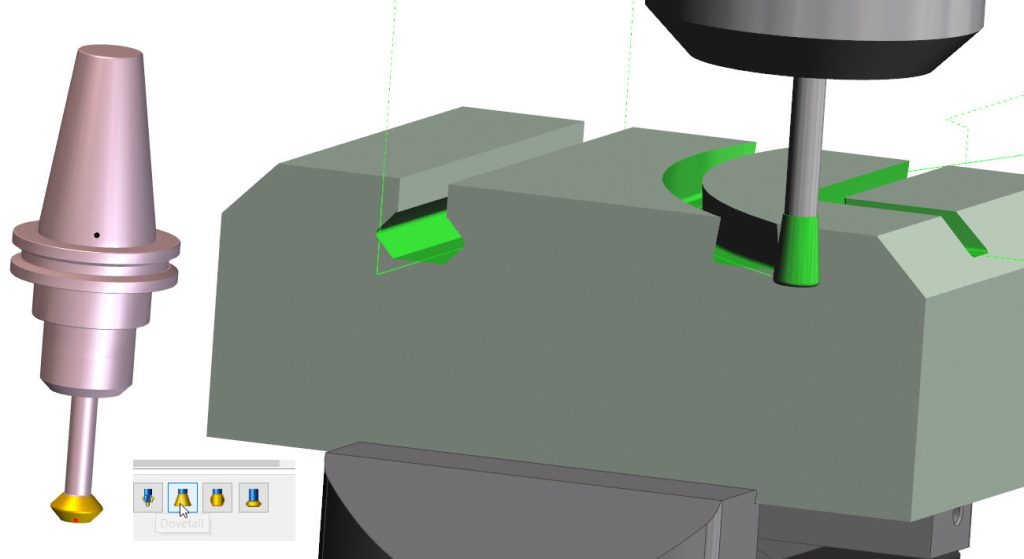

Two new tool types – Dovetail, and Double Angle – have been added to the Toolstore. This does away with the need to create custom graphics for them, saving time and programming costs. And the tools work automatically with the Slot Cycle.
