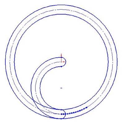

The True Hole Technology begins by using an oxygen plasma/air shield gas to pierce directly in the center of the hole, automatically adjusting for kerf compensation without shifting the pierce point. The placement of this pierce point has a dramatic effect on the resultant shape of the hole. Once the pierce is complete, the automatic gas console automatically changes the process to an oxygen plasma/oxygen shield gas which is used to cut the hole.
As shown in the Figure, a semi-circle lead-in is applied, which minimizes the amount of excess material that contributes to the size of the ding or divot. The lead-in speed is also automatically set, based on plate thickness, hole size and amperage, and varies from the actual cutting speed. After the lead-in is complete, the speed is automatically increased to full cut speed in order to cut the outer circle of the hole. Towards the end of the cut, True Hole technology automatically begins to ramp down the current. Once the outer cut crosses the original semi-circle lead-in, the current is shut off completely while maintaining full torch motion. The optimum lead-out length is also automatically applied, which varies by hole size and plate thickness. The timing of the arc-shutdown, table motion, and table deceleration are all critical to the resultant quality of the hole. These automatic parameter settings combine to minimize the ding or divot and bias it towards the outside of the hole. As a last step, once the hole has completed cutting, the automatic gas console automatically switches back to an oxygen plasma/air shield gas for further contour cutting.
