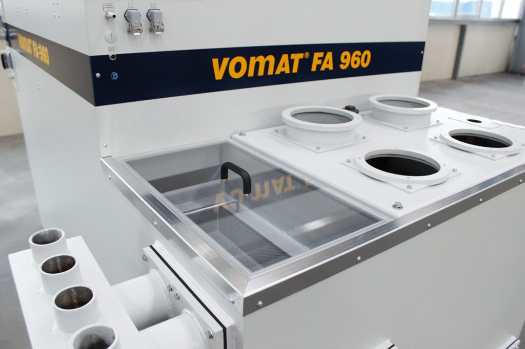

One example is the Vomat FA 960 (dimensions: 2500mm L x 1400mm W x 1500mm W), with an oil capacity of approximately 2,400 liters and 960 liters/minute filtration capacity. Depending on the amount of dirt, the high-performance filters are automatically back-washed as required, which has a positive effect on the filter durability and the energy usage. The high-precision temperature controls guarantee +/-2 K accuracy, which guarantees that the medium has a long service life. It also prevents temperature related expansion of machine components and the workpieces to be ground. In addition, there is an intelligent, fully automatic recycling system for the carbide sludge, which has a residual moisture content of around 5 to 10 percent: The patented “Sedimentator” disposes the sludge directly into a disposable transport container ready to be picked-up by the recycling companies.
