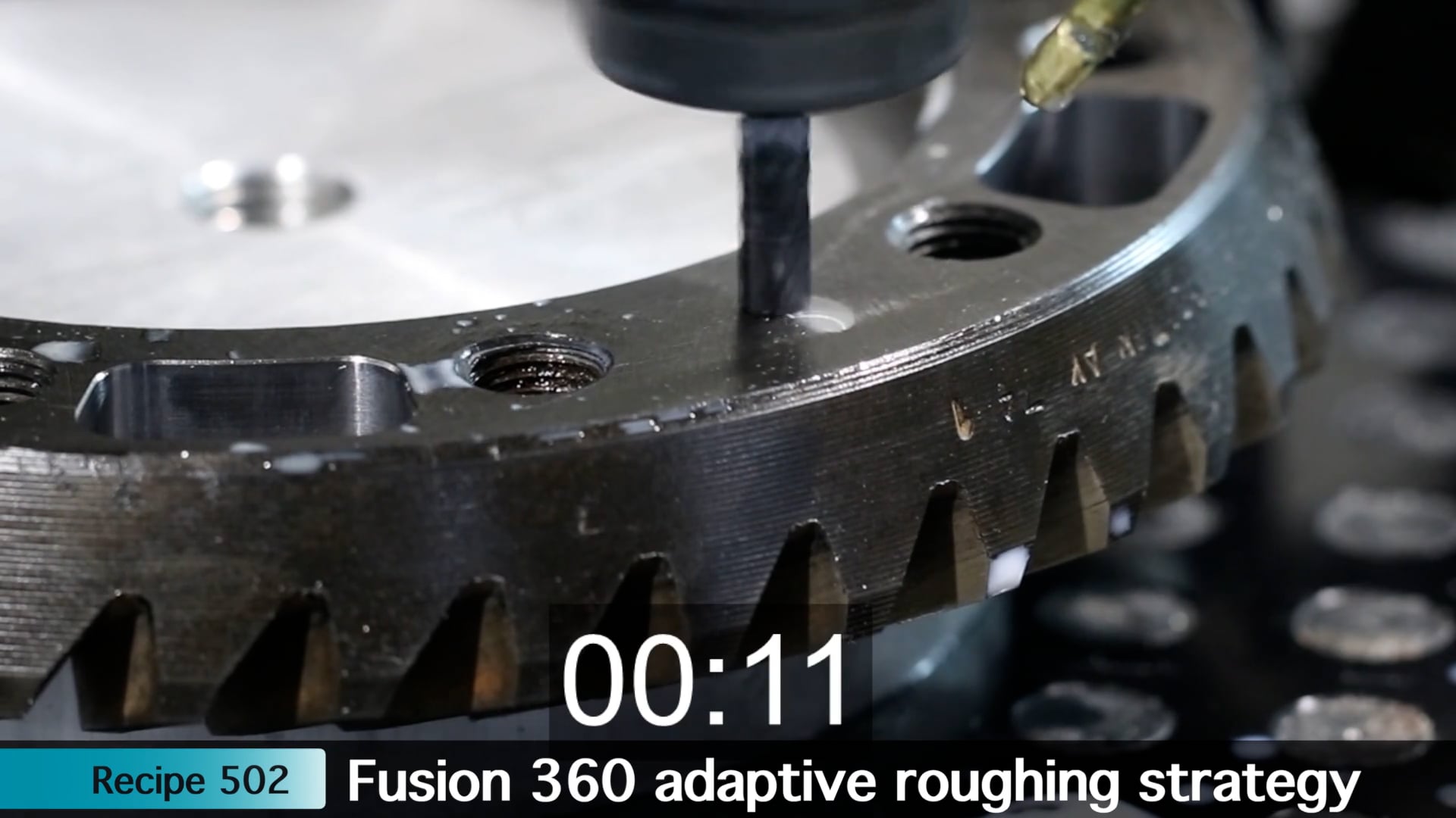

Using a Tormach 1100 CNC mill, ProvenCut demonstrates Recipe 502, a Fusion 360 adaptive roughing strategy run at 12.2 m/min. (40 sfm) and 0.033 mm/tooth (0.0013 ipt) with a 15.875 mm (0.625") axial DOC (ap) and 0.508 mm (0.02") radial DOC (ae). The demonstration shows a standard four-flute carbide endmill machining 8620 alloy steel hardened to 55 HRC.
