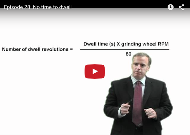

During rotary plunge dressing, a shop worker would like to know if dwelling for 2 seconds is the right amount of time. Dr. Jeffrey Badger, the host of Cutting Tool Engineering magazine's Grinding Doc Video Series, says it's not a matter of time.
