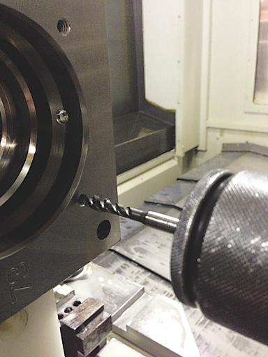

In addition to tap breakage, the issue of tool life is often encountered when tapping. Kluth noted one of the taps the shop was applying typically didn’t last 10 holes before breaking while running at 5 to 10 sfm (1.5 to 3.0 m/min.). Also, Mid Valley experienced thread size and tearing issues, which prevented a thread gage from being inserted.
To avoid tap breakage, Mid Valley tried various cutting oils and coolant formulations, but without success. The shop also resorted to starting the tapping process on a vertical machining center, then switching to hand tapping. Manually threading the gummy material, however, consumed 4 to 5 hours per part. “And sometimes we were still breaking the tap,” he said. Besides being time-consuming, hand tapping also means the machine tool sits idle.

Seeking a solution, Kluth turned to Jason Kasinski, an Emuge Corp. sales representative based in Milwaukee. Kasinski immediately recommended Emuge’s Z-Tap. According to the West Boylston, Mass., high-performance cutting tool manufacturer, the taps have an advanced chamfer geometry and rake and flute form, an increased number of flutes and a shortened thread section to reduce friction and lower torque requirements. This helps reduce tap breakage and enables higher cutting speeds.
An Emuge GLT-1-coated Z-Tap finishes threading a 316-L stainless steel part.
In addition, Kluth emphasized that the tap’s GLT-1 multilayer coating is effective for threading challenging workpiece materials, such as 316-L stainless. “The coating is really impressive,” he said.
According to Emuge, this is because the coating has an outer antifriction layer and is structured with characteristics that resist heat and help form a consistent, controllable chip that releases smoothly from the hole.
To ensure the Z-Tap was the right tool for the job, Mid Valley tested it by drilling and tapping 200 holes at 20 sfm (6.1 m/min.) in a test part, Kluth explained. “We tapped all 200 holes and the tap looked like it was not even used.”
For optimal results, Emuge recommends applying Z-taps on CNC machines with synchronous spindles using emulsion coolant and synchronous tap holders, which Mid Valley does.
Since switching to the Z-Tap several months ago, Mid Valley has not broken one tap, though it switches taps after each part to avoid the risk of breaking one and having to use the time- and money-eating tap burner, Kluth said. “If put to the test, I would bet we could get four or five parts out of one tap.”
