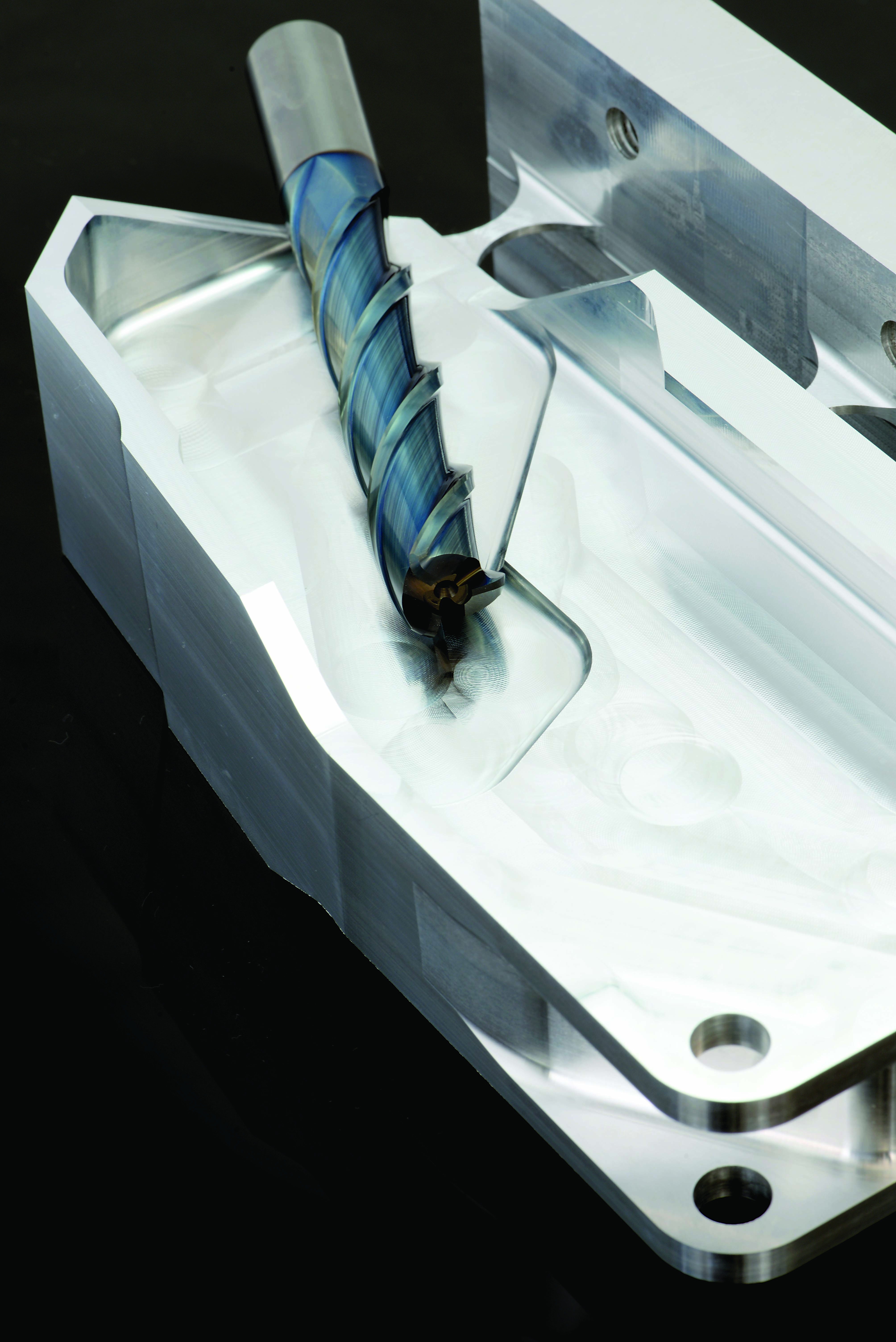

A three-flute tool finishes an aluminum part. Image courtesy of LMT Onsrud
“It comes down to tailoring a tool to a specific part and getting the most out of it that you can,” said Mitchell Parker, process improvement specialist for LMT Onsrud LP, Waukegan, Illinois. “You just have to have the right combination.”

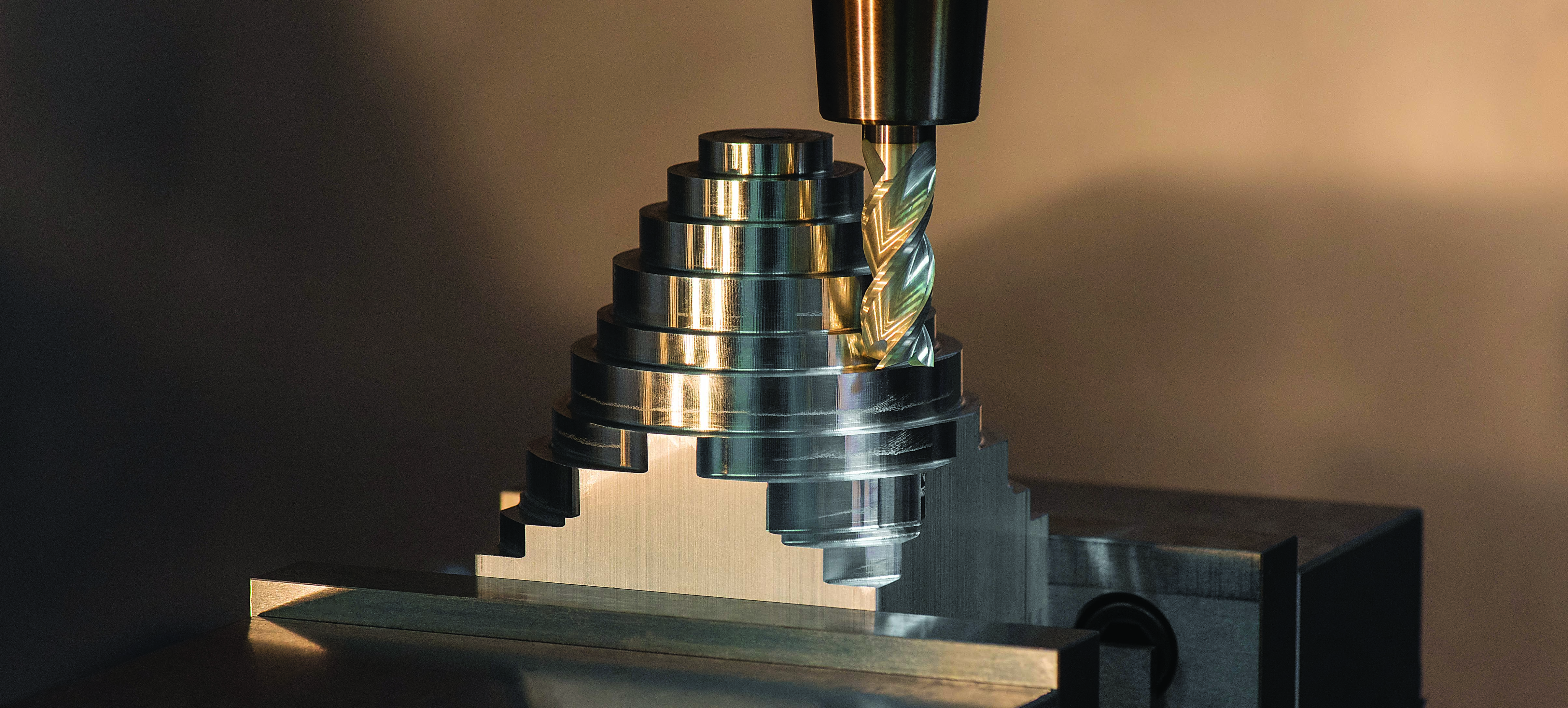

To avoid chip welding when milling aluminum, OSG USA offers tools with a diamondlike carbon coating. Image courtesy of OSG USA
“Those numbers are fine and good starting points,” he said. “But at the end of the day, when you are trying to lead the market or beat the competition, you’re not going to be at a low surface footage or low chip loads unless the material or the part dictates it. It depends on how clean the material is in the casting.”
