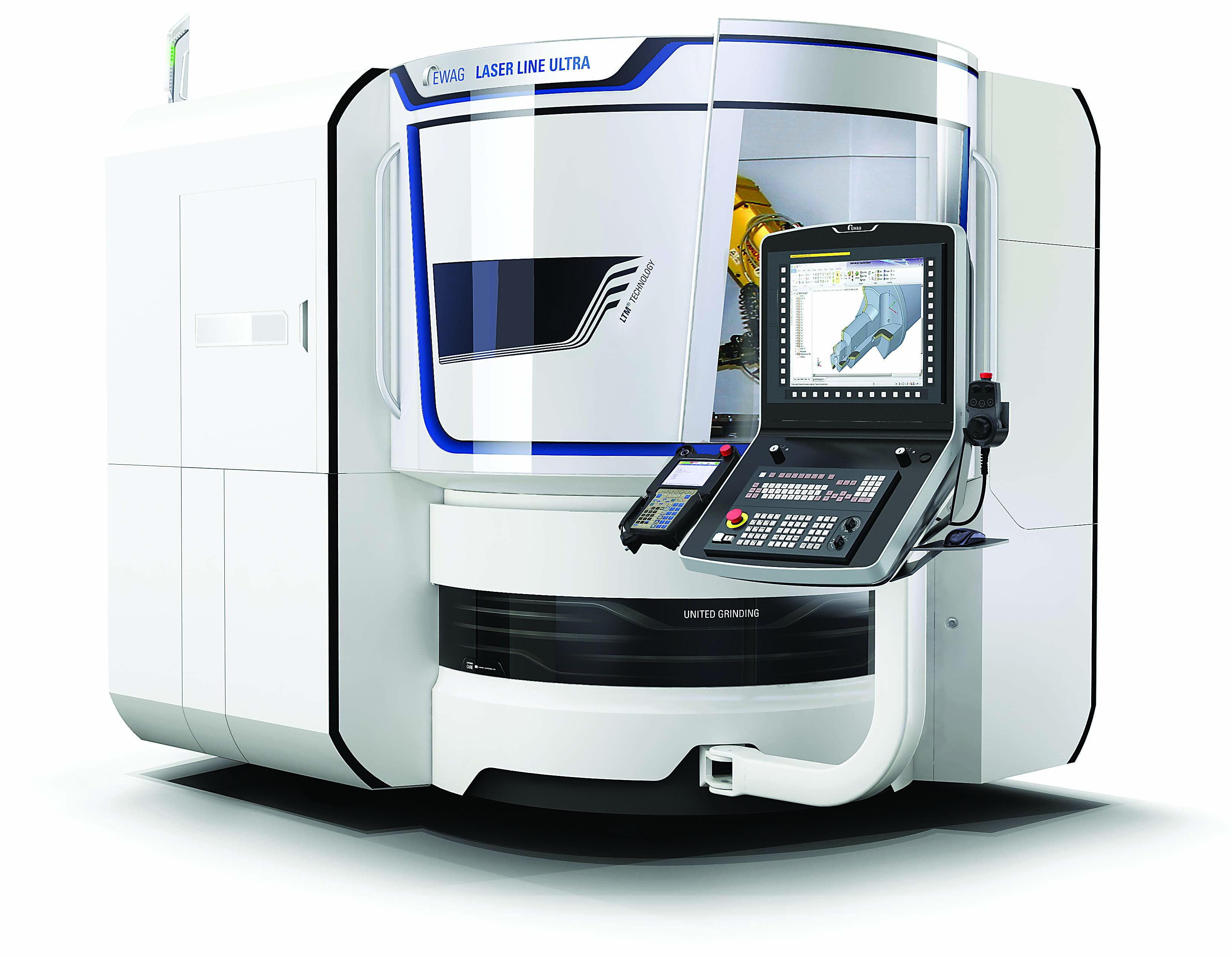

EWAG’s Laser Line Ultra with ultrashort-pulsed laser technology machines all commercially available cutting materials, including carbide, PCBN, ceramic, PCD, CVD-diamond and monocrystalline diamond without producing heat. Image courtesy of EWAG.

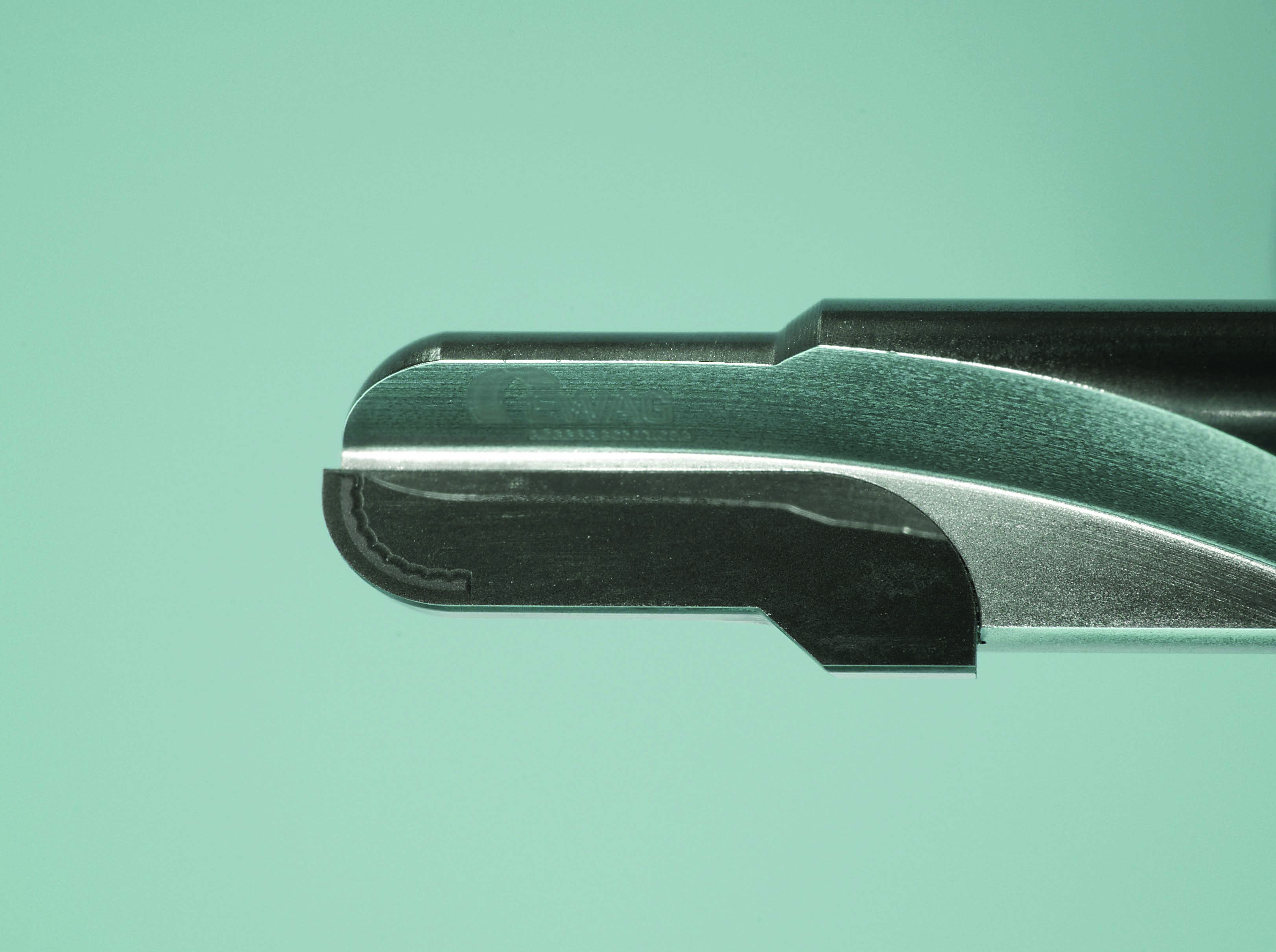

This PCD tool was produced on a EWAG machine using a Coherent laser. Image courtesy of EWAG.
