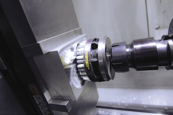

In its quest to improve throughput and part consistency by automating deburring and surface finishing, the company examined an array of possible solutions that were “all over the place” and determined that abrasive disc brushes were the best option, according to Sun. Similar to a cutting tool, an abrasive brush occupies a position in a CNC machine tool’s magazine and the machine’s automatic toolchanger places the brush into the spindle for use. This allows a CNC operator to automate deburring while imparting a fine surface finish in the same operation because the rotating brush abrades the workpiece material as it conforms around the surface being deburred.
Based on a recommendation from a tool rep, Orange Vise chose Dot-style NamPower abrasive disc brushes from Brush Research Manufacturing Co. Inc., Los Angeles. “We started using the NamPower brushes for deburring, but quickly discovered they provided a really nice surface finish,” Sun said.
The brushes contain a combination of ceramic and silicon-carbide abrasives and are composed of flexible abrasive nylon filaments bonded to a fiber-reinforced thermoplastic base, according to Brush Research. The ceramic abrasive is responsible for material removal but tends to cut a bit coarse, while silicon carbide acts as a buffer to the cutting action. The abrasive filaments work like flexible files, conforming to part contours, wiping and filing across part edges and surfaces. In addition, Dot-style brushes allow entry into small holes and spaces.
BRM%20-%20Nampower%20Brush%20in%20Action.tif
Courtesy of Brush Research Manufacturing
Orange Vise applies NamPower abrasive brushes from Brush Research to automatically deburr and surface finish the vise components it machines.
While they do remove metal, Sun pointed out that the brushes do not create tool marks and generate a surface finish fine enough to allow it to blend with the ground finishes. “With large surfaces that require multiple passes, there are no visible blends,” he said. “The whole thing looked like it was done in one pass.”
Sun noted the brushes, which add about 30 seconds to the part-making process and are applied on Orange Vise’s Mori Seiki NHX4000 horizontal machining center, made the deburring and finishing process significantly faster than the previous method.
Orange Vise uses brushes that measure 100mm (3.94"), 125mm (4.92") and 150mm (5.90") in diameter for steel, stainless steel, cast iron and aluminum workpieces. Brush changes are infrequent no matter what material is being processed, according to Sun.
He explained that after zeroing a brush to where it is barely touching the workpiece surface, the DOC ranges from 0.020" to 0.050" or more.
The company also uses the brushes to deburr the tops of parts engraved with a burr-generating 45° V-bit tool.
In addition to deburring and surface finishing, Orange Vise uses the brushes for edge blending and occasionally for rust removal when a surface isn’t wiped clean and the part is left outside.
To help dissipate heat, eliminate filament smearing, improve surface finish and extend brush life, a through-coolant toolholder is used to hold the brushes. “One of the best things to use coolant for is washing away the dust the brush creates,” Sun added.
According to Brush Research, the NamPower brushes were developed with tool longevity in mind. Because of the bristles’ linear construction, sharp new grains constantly come into contact with the workpiece surface and wear away, exposing fresh particles for consistent cutting throughout the bristle length.
Sun noted all of the brushes Orange Vise has purchased are still usable, with some having seen more than 2,000 minutes of use. “We use them just about every day and there’s definitely been no difference in performance from day one until now,” he said.
“We mainly use the 18mm bristles because our parts don’t have a whole lot of features sticking out,” he added, noting the bristles become shorter and stiffer with use. “With the 38mm bristles, youcould go much deeper without exerting as much force as an 18mm bristle.”
