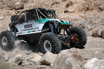

“It’s the fastest-growing motor sport today, bar none,” said David Buchberger, vice president of Hi-Speed Corp., Thousand Oaks, Calif., a manufacturer’s representative for WIDIA-brand products and services. By day, that is. By night, Buchberger can often be found making parts and maintaining his Ultra4-class racecar, which WIDIA is sponsoring for the 2012-13 season.
The defining characteristic of Ultra4 is all cars must be capable of 4-wheel drive. Beyond that, the class is unlimited, meaning all cars are custom-fabricated and come in all shapes and sizes. The fastest cars can exceed 100 mph on desert sections, while traveling 15 to 20 mph through the rocks is “flying,” Buchberger noted. Gear ratios are as low as 100:1 for technical rock crawling.
“It’s challenging because if you build a vehicle that excels in one area, it usually does worse in the other,” he said, noting that heavy and swift is best for the desert and light and nimble helps on the rocks. “People always try to find creative ways to make it go faster in the desert but not too lousy in the rocks and vice versa.”
After the first two cars he built for competition proved not competitive enough, Buchberger started building another one when Bernie McConnell, vice president of WIDIA Products Group and Services, Latrobe, Pa., caught wind of the project. “Bernie and I were talking about how he had heard about KOH and what I would think of WIDIA sponsoring the car,” Buchberger said. “My first thought was this is an unbelievable opportunity. I give a lot of credit to Bernie for taking a big risk on me when I just had a frame, an engine and a transmission sitting in my garage.”

When building his Ultra4-class racecar, David Buchberger applied ½ " and 3/16 " VariMill II endmills from WIDIA to mill a 0.040 "-thick honeycomb pattern in 1018 steel and maximize reinforcement while minimizing weight.
