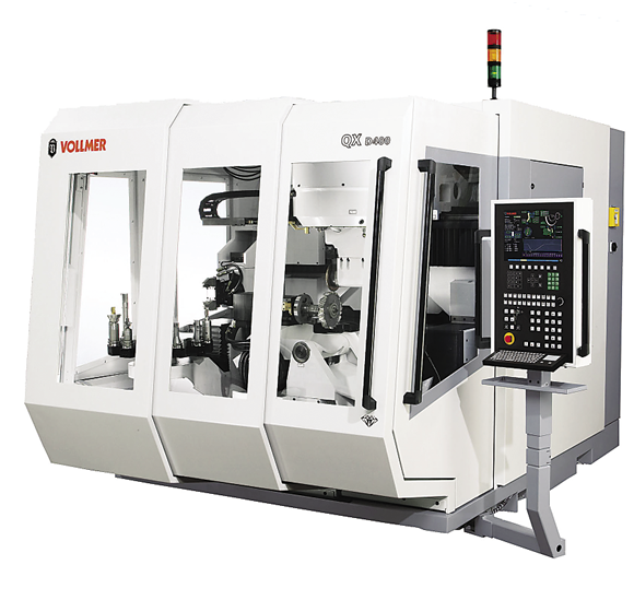

After researching its options, NAP GLADU purchased a QXD400 rotary erosion machine from Vollmer of America Corp., Carnegie, Pa. The machine met the toolmaker's rotary erosion requirements, and NAP GLADU also has a long history of satisfaction with Vollmer's equipment and service, Berlinguette noted. "It was a big part in our final decision."

The Vollmer QXD400 rotary erosion machine can produce a range of cutting tools.

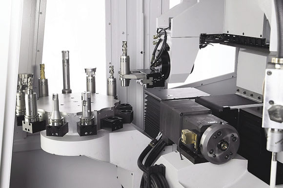

The machine's six-position toolchanger allows for flexibility in the types of electrodes that can be applied in unattended operation. That benefits NAP GLADU, Berlinguette noted, because the machine can run for up to 36 hours without operator intervention, and the company only runs a single shift on the weekends compared to three shifts throughout the rest of the week. This enables the machine to produce tools from around 11 o'clock on Friday evening until Sunday morning before it needs attending.
