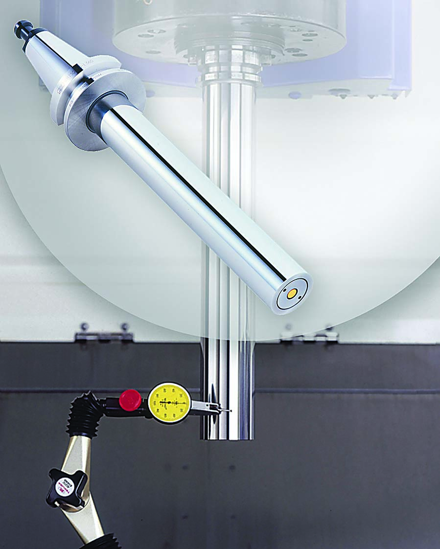

Dyna Test is a precision test bar for static accuracy of a machine spindle. Using Dyna Test bars for regular inspection helps identify potential problems. Image courtesy of BIG KAISER Precision Tooling

Test Static Accuracy
Another way to confirm spindle performance or ensure that bearings are holding up is to inspect the accuracy of spindle movement. Any runout in a spindle will be amplified as it extends through the tool and into the part. Similarly, if z-axis movement is not parallel, users will see the resulting imperfections on parts. I recommend using a test bar that's inserted into the spindle and a touch probe to measure movement. Simply spinning the spindle slowly or moving it along the z-axis while the probe is on the bar will reveal any issues.
