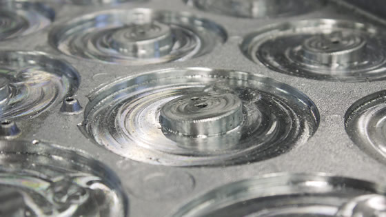

It’s common knowledge that superhard materials can be used to make cutting tools with exceptionally long life. But a medical device maker really hit the jackpot when it replaced a solid-carbide endmill with a PCD one and experienced a more than 5,600 percent improvement in tool life, while efficiently producing high-quality parts. Simeon Medical GmbH & Co. KG, Tuttlingen, Germany, experienced that outcome when the manufacturer of surgical light housings needed a longer lasting endmill to more productively mill circular pockets in the cast aluminum housings. Depending on the model, each housing has 24 to 36 pockets to hold LED lights.
The parts manufacturer was applying uncoated solid-carbide endmills that had roughing teeth with a chipbreaker geometry. Tool life averaged from 12 to 14 housings. Simeon tested a coated carbide tool, but tool life increased only three to five housings.

A special PCD endmill from JBO mills a circular pocket in cast aluminum at Simeon Medical.

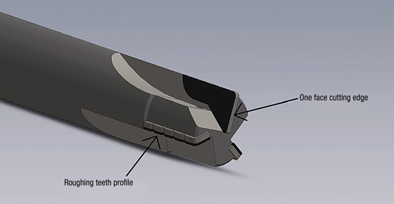

Seeking to reduce costs and further extend tool life, Simeon commissioned Johs. Boss GmbH & Co. KG (JBO), Albstadt, Germany, to develop a solution. (J.M. Sales – USA, Troy, Mich., is JBO’s U.S. representative.) The toolmaker selected PCD as the cutting tool material and produced an endmill with chipbreaking roughing teeth. The 3-flute tool measures 16mm (0.63 ") in diameter and 90mm (3.54 ") in total length and has 24.90mm-long (0.98 "), 1.60mm-thick (0.06 ") PCD cutting edges with a 0.80mm (0.03 ") end radius.
In addition, JBO laser-machined the cutting edges. Compared to the conventional method of wire EDMing the edges, laser machining produces an ultrasharp cutting edge with minimal chipping and edge rounding, according to JBO. For example, if the EDM’s eroding wire is 0.3mm (0.01 ") in diameter, the cutting edge radius is 0.15mm, whereas laser machining can generate an edge radius as small as 0.02mm (0.0008 "), explained Sandro Conzelmann, application technician for JBO. “And we can produce more filigree geometries than is possible with wire erosion,” he said.

JBO designed the PCD endmill for Simeon Medical with roughing teeth on the external diameter and a face cutting edge.
