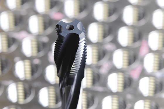

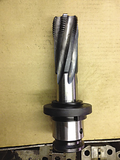

The HY-PRO HXL tap from OSG is for threading difficult-to-cut alloy steels, such as 4140 and 4130. Below: An HY-PRO HXL tap shows little wear after tapping 100 holes in 4140 at D&N Machining.

In addition, Portwine recommended running the tap at 25 sfm (48 rpm at 6 ipm) and even contacted his colleague Mike Brzezniak to confirm his recommendations based on the application details and Brzezniak’s success with the tap being applied by part manufacturers in the Houston energy market.
D&N purchased two of the taps from OSG and ran them the next day on the shop’s Haas HS-4R horizontal CNC mill, using flood coolant. The parts were held in a fixture D&N produced in-house that has large V blocks with hydraulic chains as the clamps, Hankins noted.
The tap ran in a tension-compression toolholder at the recommended speed and successfully threaded the 100 holes. The machine operator noted the tap provided effective chip control, generating straw-colored chips predominantly shaped like sixes and nines.
After the job, the tap still looked new, according to Hankins, who plans to use it for other applications and possibly for repeats of the initial job. “This was the first run on the part and our customer will dictate the return of the job,” he said.
