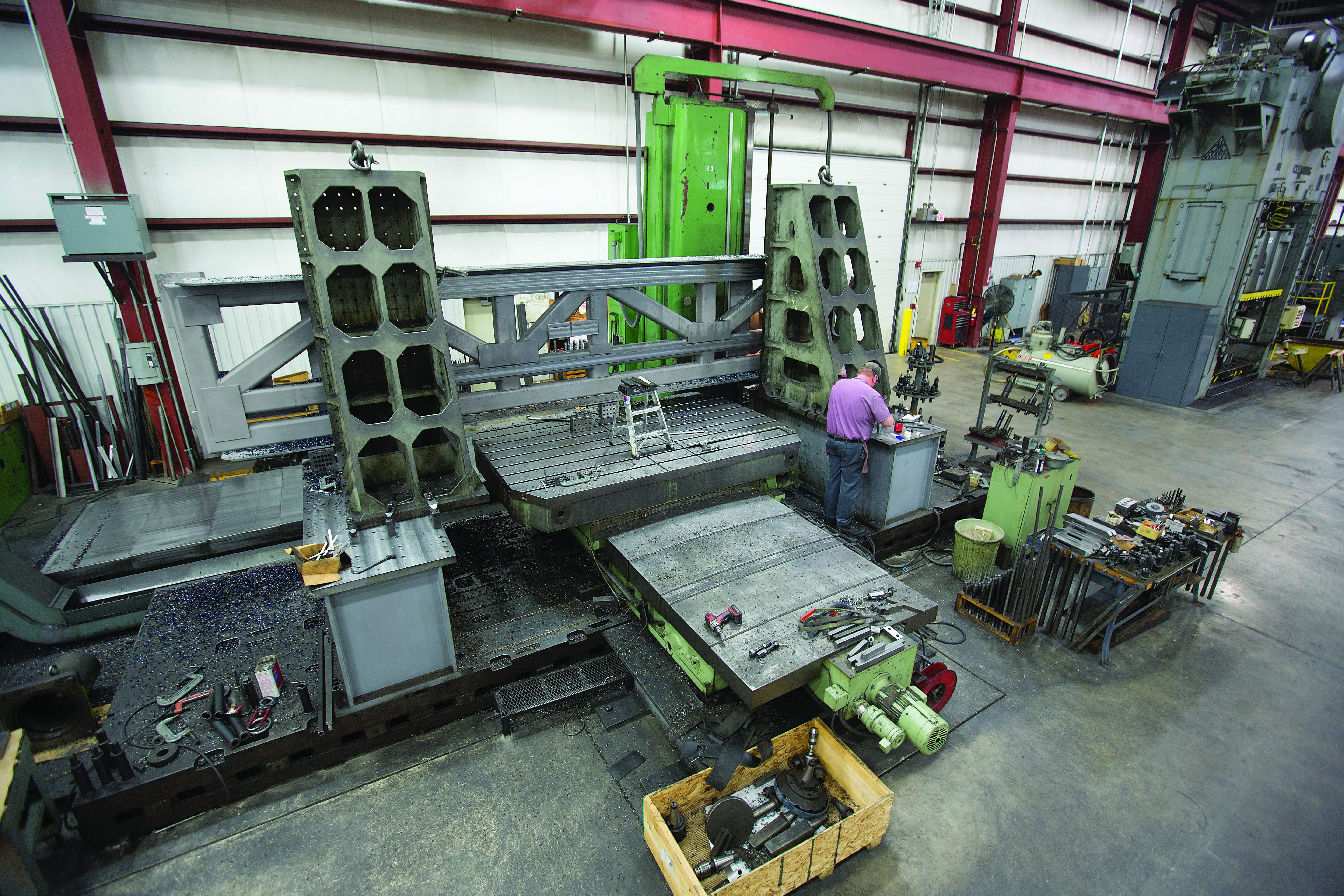

Some even stretch the upper limits of CMC’s biggest—and oldest—machine tool, a 1968 Wotan boring mill that has a 260" (6,604mm) X-axis travel and a 91" (2,311mm) Y-axis travel, said Manufacturing Manager Steve Zoda. “We’ve had some 300" parts on that machine.”

This 1968 Wotan boring mill has a 260" X-axis travel. Image courtesy of Coldwater Machine.

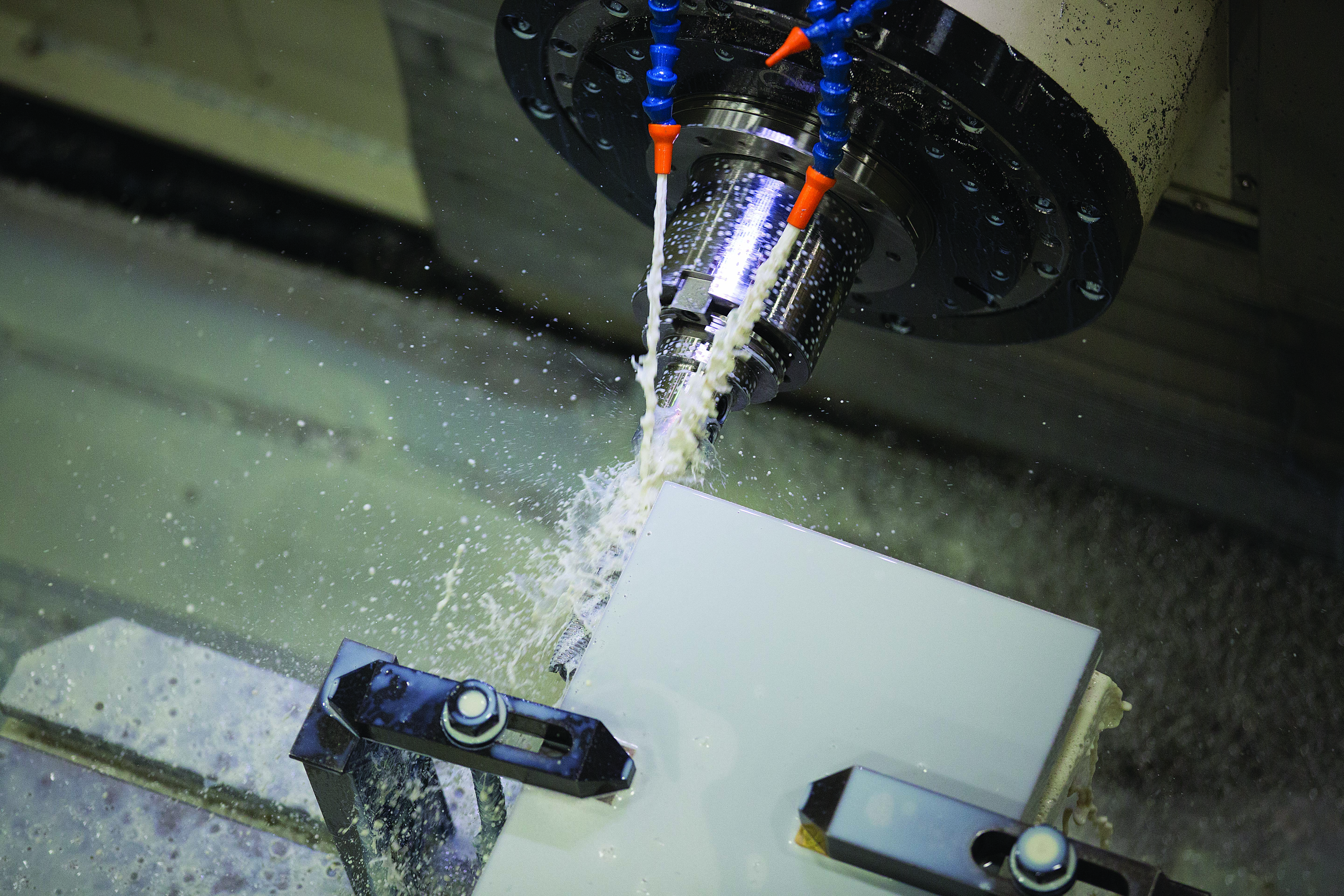

In addition to being large, many of the parts Coldwater Machine produces are made from workpiece materials that are challenging to cut, including Inconel, titanium, tool steel and Hastelloy, as well as 15-5 and 17-4 stainless steel. For instance, Zoda said roughing heat-resistant superalloys previously involved running the tool at a relatively slow cutting speed and removing a lot of material—hogging it. That approach requires high-horsepower, high-rigidity
machines.
A more effective method, according to Zoda, is to take lighter cuts at a higher feed rate. “You might be only taking a 0.030" DOC but at 250 sfm. You remove a lot more material that way.”
He added that CMC—with the assistance of a tool engineer from its supplier—regularly tests high-feed milling cutters and other cutting tools when preparing for a new project that involves a difficult-to-machine workpiece material. “The supplier comes in, takes a look at the project and says, ‘I recommend this tool, and I’ll bring one in and see how it works.’”

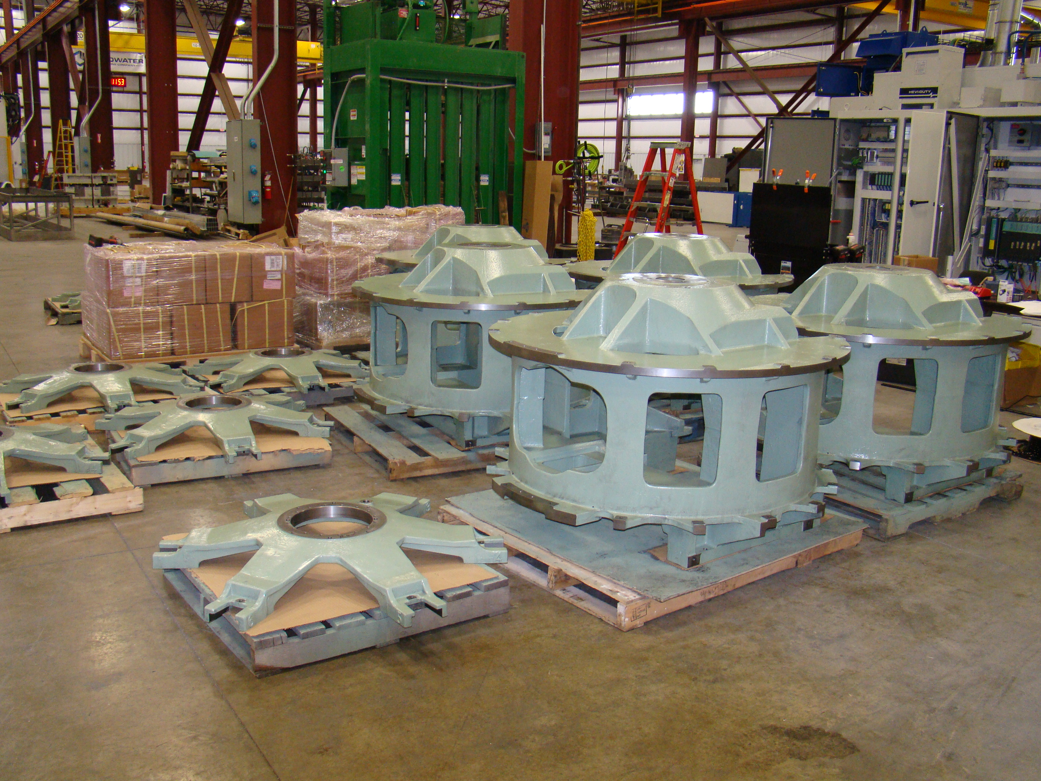

A sampling of the large parts Coldwater Machine produces. Image courtesy of A. Richter.

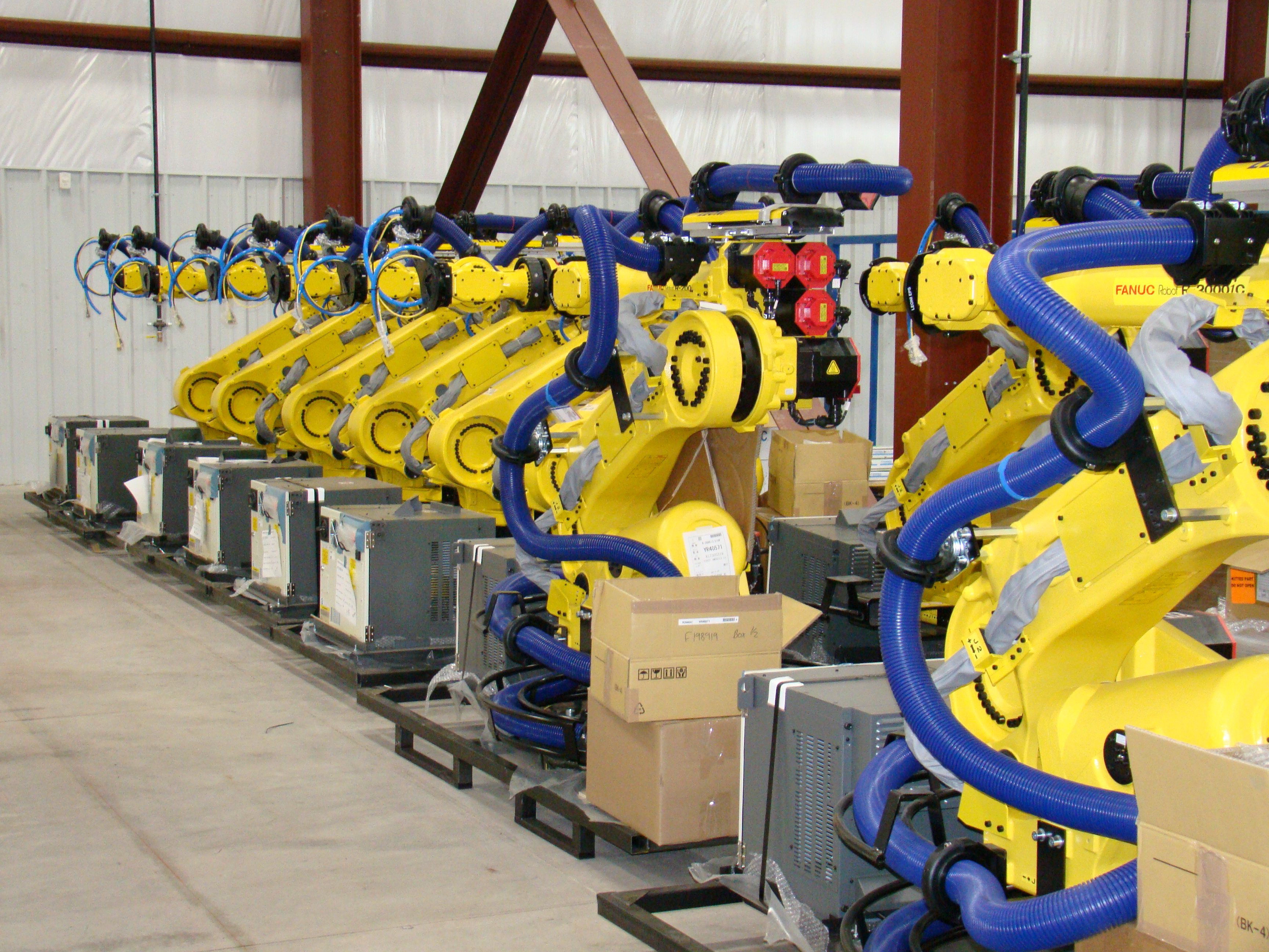

FANUC robots in the build area will be configured into an automated production system. Image courtesy A. Richter.
