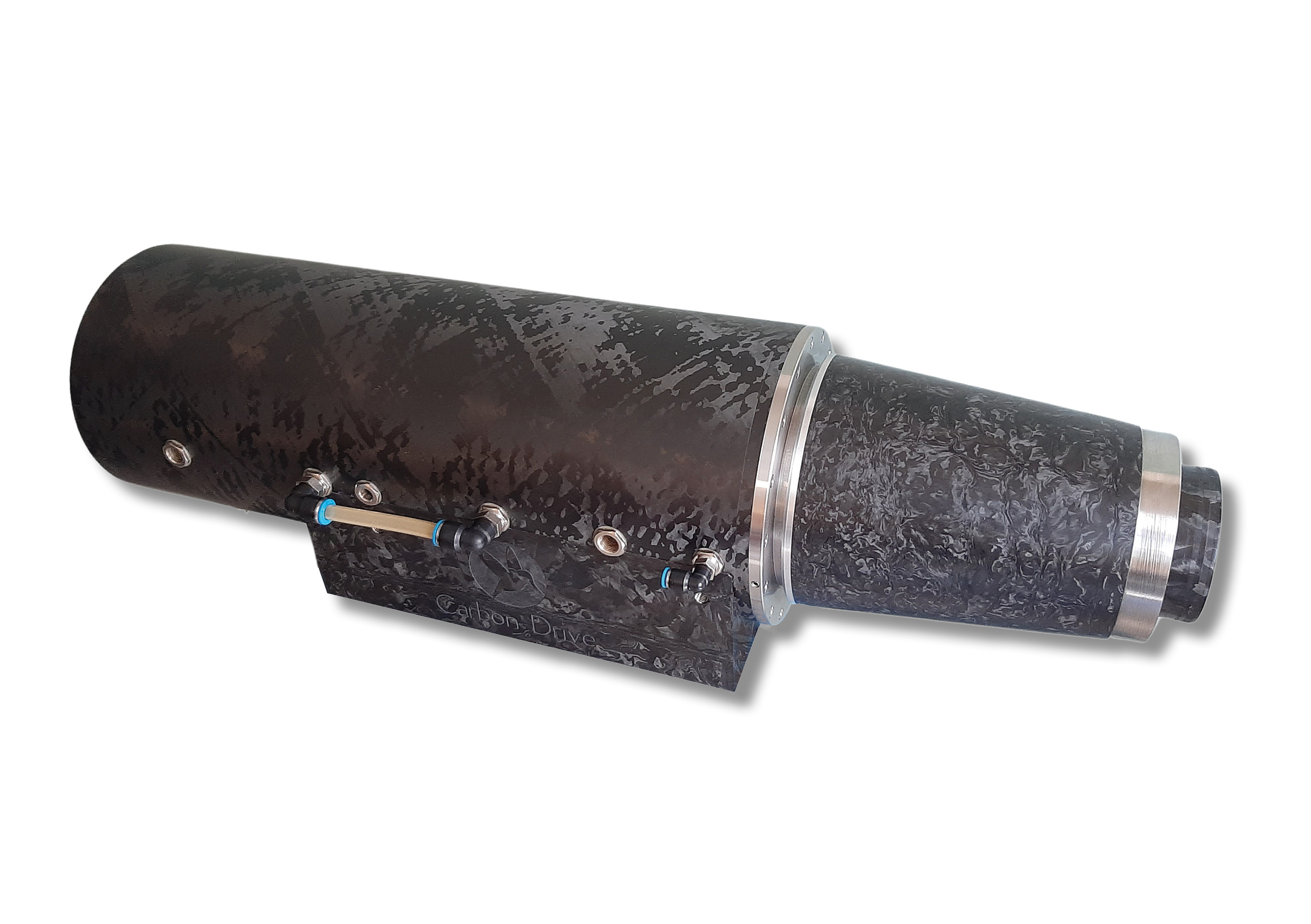

Karbon spindel

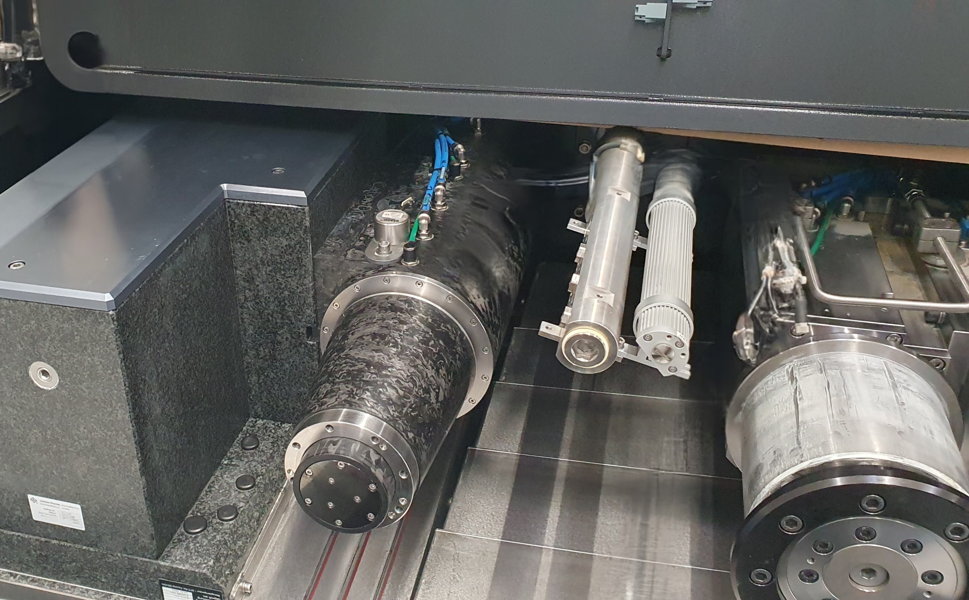

The carbon fiber spindles developed in collaboration with Carbon-Drive GmbH have been tested and adapted for more than six months - with promising results.
"The high grinding quality with full grinding gap coverage was already a quality feature of our machines. With the carbon spindles, we are further optimizing this aspect and pushing it to the maximum," added Tschudin. The introduction of carbon spindles, explains Mr. Tschudin, is the final step in a decades-long development process. Tschudin has been using linear motors for 30 years. More than 25 years ago, machine beds made of solid natural granite were used, which only heat up extremely slowly due to their large dimensions and inertia. In a further step, the grinding spindle slides were also designed as granite blocks - the vertical stop surface for the spindles led to a drastic reduction in heat transfer. On the ecoLine 400, a spindle made of Invar that was implemented ten years ago has ensured a ten percent reduction in heat transfer. The carbon fiber spindles, for which Tschudin has applied for a patent, have now reduced the heat transfer to an absolute minimum.

"How materials react to heat has a major influence on precision manufacturing. The temperature resistance of carbon fiber is particularly high-carbon spindles therefore prevent thermal expansion in the machine. They are more dimensionally stable and have a higher bending stiffness, which means they can run at higher in-feeds, which in turn means higher cutting performance. In a series of tests, the carbon spindles have proven to be between ten to twenty percent more effective than steel spindles," said Nikolas Ernst, Head of Design at TSCHUDIN AG.

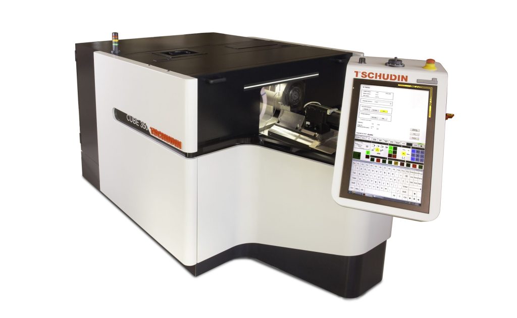

The TSCHUDIN CUBE 350 is the latest Tschudin centerless grinding machine that is designed to produce parts up to 20mm in diameter and to plunge grind parts up to 150mm long. It is also equally adept and thorough feed grinding of parts. It can be equipped with various automatic loading options and pre and/or post-processThe carbon fiber spindles gauging. It offers the best possible efficiency with a small footprint.
The changeover time is reminiscent of a pit stop in Formula 1: The change of the grinding and regulating wheels can be done in just six minutes and the next series of workpieces can then be produced seamlessly. The compact centerless grinding machine has a base of just 2.60 m x 1.70 meters and has been developed specially for machining small components. Its ergonomic design is unique, and the machine can be operated from both the left and the right side.
The standard version of the CUBE 350 will continue to be equipped with steel spindles. The carbon spindles are available as an option.
