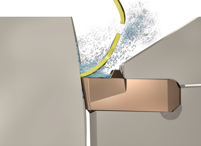

The Chip Breaking Effect: Direct delivery of cutting fluid to the work zone together with a variety of application-specific chipbreakers provides the Beyond Evolution™ grooving and cut-off system robust chip control while substantially extending tool life.

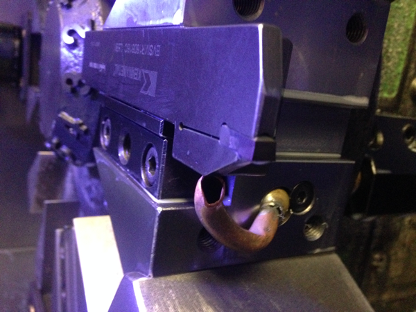

“The Daewoo isn’t equipped with high pressure cutting fluid, and the standard pump was unable to generate enough pressure for us to utilize coolant through the tool on our old cut-off system,” he explains. “Because of this, we’ve been stuck with flood coolant, and have always had some chip control issues as a result—the chip would roll back on itself and starve the cutting edge of coolant.”
Despite the less than perfect cutting conditions, the Beyond Evolution performed beyond expectations. “We achieved very good results,” says Dotson. “This time we increased the cutting speed a bit, from 350 to 400 sfm, and bumped up the feedrates by about 30 percent. Even so, tool life increased threefold, to just over 2600 pieces per insert. I’m confident we could have cranked up the feeds and speeds even more, especially if we had plumbed the tool for coolant through, but there was no need. This operation supplies another machine, and that one was already running as fast as it could go. The big thing for us was getting more parts between tool changes, and that’s exactly what the Beyond Evolution did. It’s an excellent product at a very competitive price point.”

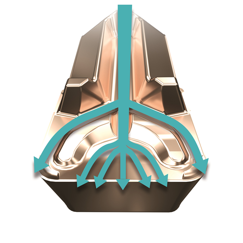

The Fan Effect: Specially designed coolant delivery channels in the Beyond Evolution™ system separate and direct cutting fluid to where it’s needed most, underneath the chip and into the work area.

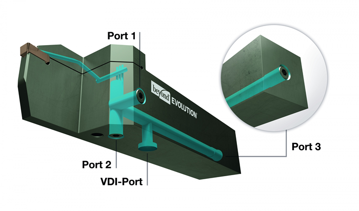

Many options through multiple ports
Don’t have the right adapter or hose? It’s not a problem with Beyond Evolution™ toolholders, which are ported for KM, VDI, and virtually all machine platforms, and is capable of pressures up to 350 bar (5076 psi).
