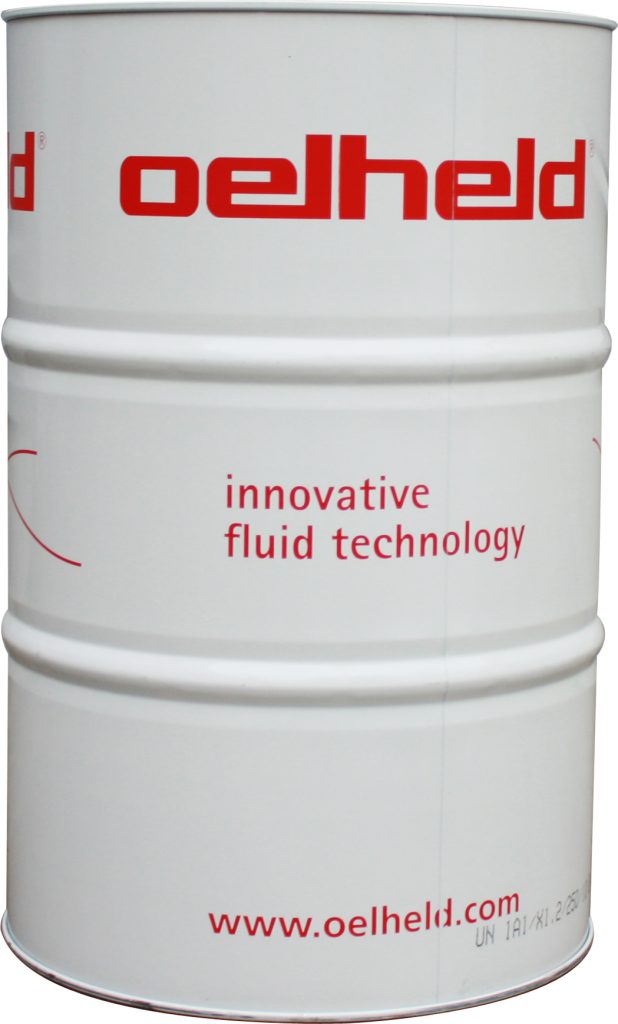

AirForge 4028 is a newly developed protective lubricant for hot forging of steel and alloys. It delivers outstanding results when metal protection against oxidation, gas diffusion and heat is required.
AirForge 4028 is colorless and does not contain graphite. It provides the much desired clean work and shop floor conditions most plant managers are yearning for, according to the company. AirForge 4028 is diluted in water and can be used either by dipping or spraying the metal blanks.
The product provides excellent results in a range of operations, even on challenging workpiece shapes. It is free of lead or any other toxic components and does not contain solvents.
