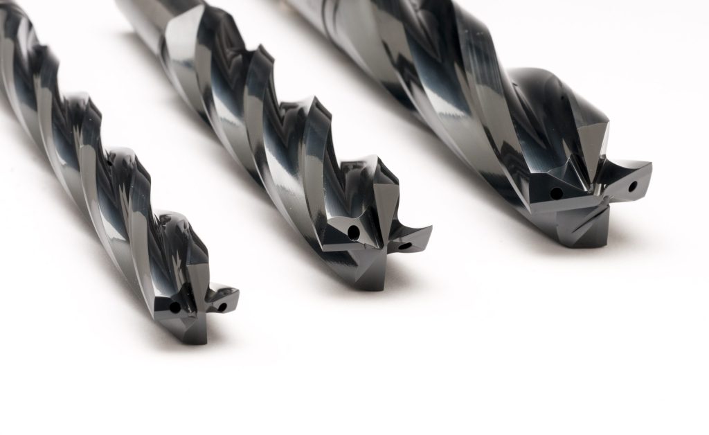

Star Cutter Company’s core drills, custom-designed and built per application, are well-suited for the machining of cylinder heads, cylinder blocks, valve bodies, fluid power components, and other cast components that are made of aluminum and iron, including CGI. Based upon review and input from the Star Cutter design team, decisions are made regarding three- or four-fluted design, edge prep, material grade and advanced coating selection so that each drill is optimized per specific requirements, leading to reduced cycle times.
Used for both enlarging or finishing holes from a castings core pin condition, a major advantage of the Star Cutter core drills is that they are proven to cut straight holes that correct shifts in a cored hole location, which can occur during the casting process. These drills are also adept at preparing holes for a second pass in tight tolerance reaming, optimizing the hole size and location results.
Designed for use with coolant or Minimum Quantity Lubrication (MQL), the Star Cutter core drills feature a drill point machined from either a solid part or a cored condition. These tools can be reground multiple times for a very competitive cost per hole. They are also well-suited for interrupted machining operations and can reduce cycle time over traditional two-edge cutting tools.
Available in diameter sizes starting at 8mm, each drill order should be accompanied by casting and tool layout prints. Multiple diameter step core drill options are also available.
