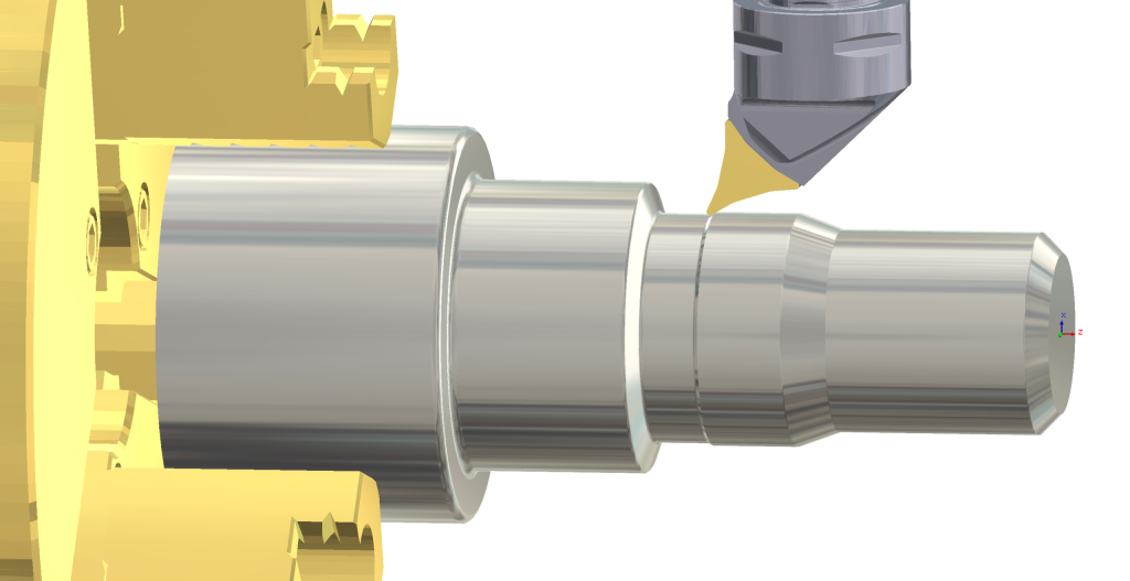

HCL CAMWorks 2021Plus is one of the first integrated CAM systems to support Sandvik Coromant's PrimeTurning, which uses CoroTurn Prime Type-A and Type-B tools in conjunction with unique toolpaths to achieve increased feeds and speeds, shorter cycle times and longer tool life. PrimeTurning offers the flexibility for turning operations in all directions. The shape of the CoroTurn® Prime tool inserts, combined with toolpaths that turn in the opposite direction than a conventional turning process, makes it possible to achieve a much smaller entry angle and better chip control.
HCL Technologies (HCL), a leading global technology company, today announced the release of HCL CAMWorks 2021Plus, with support for Sandvik Coromant PrimeTurningTM, multiple technology databases and new tutorial task panes.
HCL CAMWorks 2021Plus is one of the first integrated CAM systems to support Sandvik Coromant's PrimeTurningTM, which uses CoroTurn® Prime Type-A and Type-B tools in conjunction with unique toolpaths to achieve increased feeds and speeds, shorter cycle times and longer tool life. PrimeTurningTM offers the flexibility for turning operations in all directions. The shape of the CoroTurn® Prime tool inserts, combined with toolpaths that turn in the opposite direction than a conventional turning process, makes it possible to achieve a much smaller entry angle and better chip control. This allows the machine to achieve a higher feed rate – typically 2 to 3 times faster than conventional feed rates – while still maintaining the same close tolerances and quality finishing. The direction of the toolpaths provides the ability to machine right up against a 90-degree shoulder on parts. PrimeTurningTM also significantly extends tool life by spreading load and high heat over a longer distance, which extends tool life up to 500% longer than using conventional turning methods.
