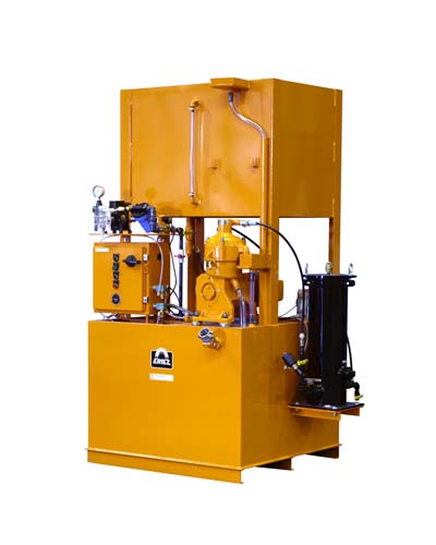

The four models of Eriez HydroFlow Coolant Recycling Systems include the following:
CRS 120SS is designed for plants operating with one coolant and total coolant sump capacity not exceeding 2,500 US gallons (9,300 liters). This model features side-by-side 120-gallon (455 liter) dirty coolant tank and 160-gallon (600 liter) clean coolant tank. The Coalescer removes tramp oil at the rate of two gallons per minute (7.5 liters per minute). High-speed centrifuge is optional.
CRS 120ST is also built for plants operating with one coolant and total coolant sump capacity not exceeding 2,500 US gallons (9,300 liters). This model features a stacked 120-gallon (455 liter) dirty coolant tank and 160-gallon (600 liter) clean coolant tank. The true high-speed centrifuge requires only one pass through the system to remove tramp oils, particulate matter and a substantial portion of the bacterial population. Cleaning the fluid to this degree eliminates the need for expensive, energy-intensive coolant pasteurization.
CRS300SS is a complete, full capability single product coolant recycling system for medium-to-large metalworking plants with recycling with up to 10,000 gallons (37,854 liters) of total sump capacity. This unit features a 300- gallon (1,140 liter) dirty coolant tank and 450-gallon (1,700 liter) clean coolant tank. The true high-speed centrifuge requires only one pass through the system to remove tramp oils, particulate matter and a substantial portion of the bacterial population.
CRS 300ST is designed for plants operating with one coolant and total sump capacities not exceeding 5,000 U.S. gallons (18,900 liters). This model features a stacked 300-gallon (1,140 liter) dirty coolant tank and 450-gallon (1,700 liter) clean coolant tank. An optional dual product design, referred to as the CRS 200/200 ST, features two dirty and two clean tanks for facilities using two different metalworking fluids.
