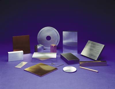

TCI Precision Metals ships custom, precision Machine-Ready Blanks throughout the U.S., saving shop owners time and money, while increasing production capacity by 25 percent or more.
February 13, 2013
TCI Precision Metals ships custom, precision Machine-Ready Blanks throughout the U.S., saving shop owners time and money, while increasing production capacity by 25 percent or more. Machine-Ready Blanks are ready to be placed directly onto the customer's machining centers, eliminating time-consuming prep work.
Based on using customer provided data, practical experience and simulation software, TCI has effectively calculated the actual time and resources required to prepare machine-ready material to spec from rough stock. This includes sawing, squaring, grinding/milling to tolerances of +/-.0005" dimensionally and .0002" flatness, squareness and parallelism. Actual productivity gains vary depending on job specifications, but the results of this in depth analysis reveals many shops gain as much as 25 percent capacity using Machine-Ready Blanks, without adding equipment or people.
