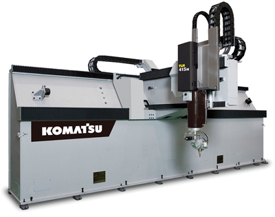

Komatsu has announced advances made to its NTC TLH 5-axis fiber laser processing systems. The cantilever-style TLH models now offer a new control system and teach pendant to allow for easier operations and use. The controller, labeled 06R is an upgrade from the previous proprietary 05R NTC controller. The new controller provides easier to read screens with touch screen activation leading to faster processing times.
The new teach pendant response time has improved from two seconds to a half second, is ergonomically advanced for operator use and provides a safety interface to ensure that two hands are on the pendant with automatic shut off should one hand be removed. The TLH also comes with a new color scheme for a contemporary look and new Komatsu badging.
The TLH Series features two models: The TLH-414N a shuttle pallet system and the TLH-408N with a 110" dia. rotary table. Cutting speed to 1,575 in/min (40,000mm/min) can be achieved and the series features an IPG fiber optic generated and beam delivery system with 3kW power option.
The fiber laser series has been shown to achieve processing times two to three times faster than traditional carbon dioxide and provide significant savings in operating costs. It is ideal for hot stamping applications and high speed cutting of thin gage mild steel, aluminum or stainless steel up to ¼" (6mm).
Depending on the model, the TLH 5-axis series provides X, Y and Z axis travel up to 177" (4500mm), 45" (1150mm) and 20" (500mm) respectively with positioning accuracy of within +/-0.05/500mm (+/-0.002"). Combined with its controllable optical head angles of +/-720 degrees on the C axis and rotation of +/-135 degrees, on the A axis, the TLH models can operate in virtually all cutting applications.
The series provides two pallet options: a 4" x 8" shuttle for larger parts processing or a 110" dia. rotary table for increased flexibility and production for smaller parts and volumes. The system uses a Windows operating environment, noncontact gap sensor technology, controllable optical head angles, and operator friendly joystick and hand-held pendant.
