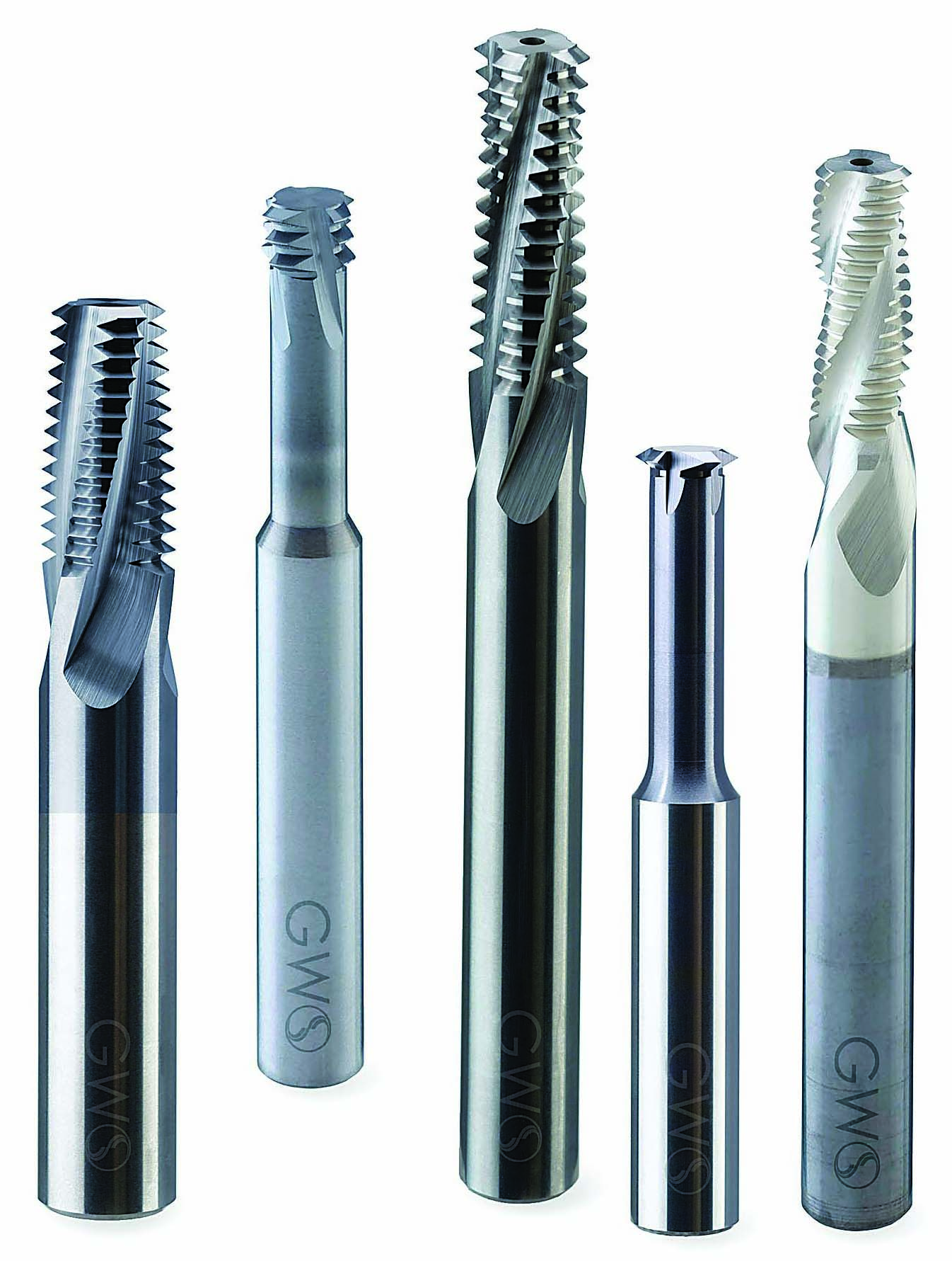

These thread mills feature a helical flute design and are manufactured from premium micrograin carbide for increased life and improved thread quality. Image courtesy of North American Tool

North American Tool offers a line of taps and thread mills. The thread mills for exotic alloys, much like Emuge's ZGF line, are designed with only three teeth.
"So there is less stress on the tool than (with) a conventional thread mill with six or eight or 10 teeth engaged in the material at the same time," Strauchen said.
