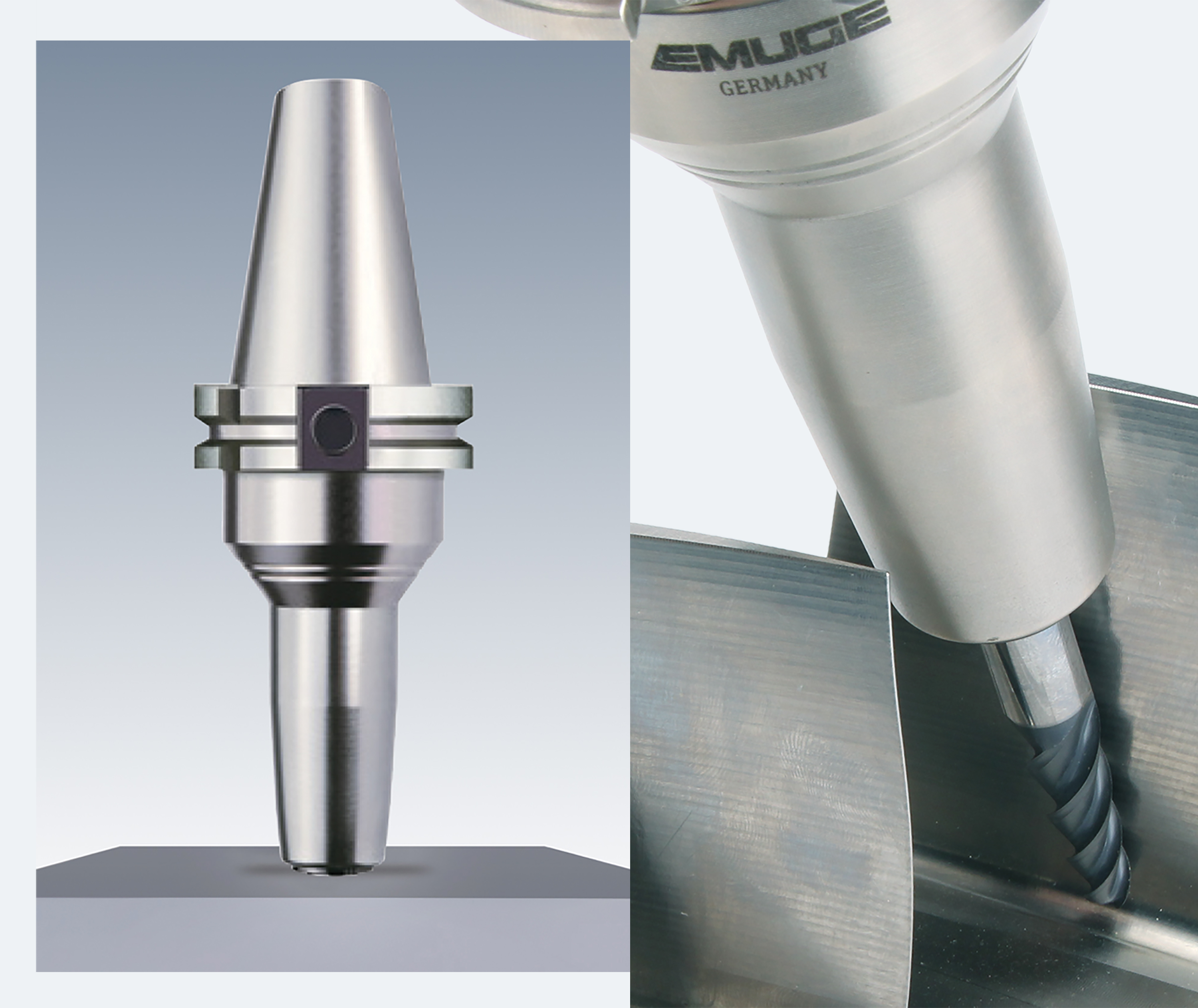

FPC Collets
Emuge Corp.’s FPC collets are designed for precision with minimal flexibility. They conform to ISO H6-H9 standards and fit one specific tool diameter. The newly introduced Slim Line models address challenges in confined workspaces, especially for five-axis machining.

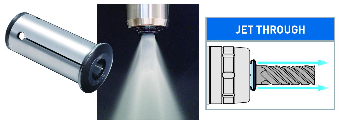

BIG KAISER’s Perfect Seal and Perfect Jet Collets
BIG KAISER Precision Tooling introduced Perfect Seal and Perfect Jet collets for hydraulic chucks:
- Perfect Seal: Seals the tool shank to allow high-pressure coolant flow.
- Perfect Jet: Improves coolant delivery along the tool shaft by reducing clearance between the collet and tool.
