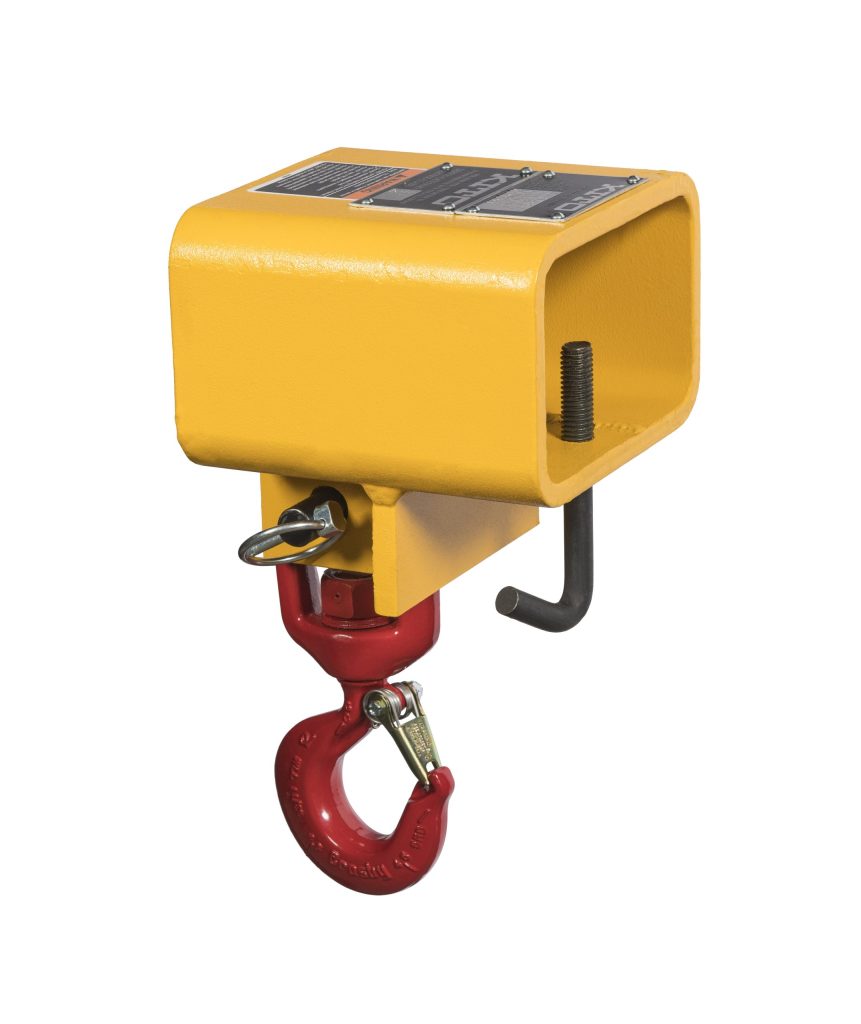

Harrington Hoists Inc. introduces its HFH Fork Truck Hook, which is designed to lift and carry loads on the fork of a fork truck using a single latched hook or swivel hook. It is available to fit fork widths of 5¼ to 7 inches and 3¼ to 3 inches in height with a capacity of 1½ tons.
May 31, 2019
Harrington Hoists Inc. introduces its HFH Fork Truck Hook, which is designed to lift and carry loads on the fork of a fork truck using a single latched hook or swivel hook. It is available to fit fork widths of 5¼ to 7 inches and 3¼ to 3 inches in height with a capacity of 1½ tons. Additional sizes and capacities are available.
The HFH Fork Truck Hook easily attaches to forks and is engineered and manufactured to ASME B30.20 & BTH-1 Design Category B Service Class 2 and has a specified fatigue life of 100,001 to 500,000 load cycles. All HFH Fork Truck Hooks are proof-tested to 125% capacity.
