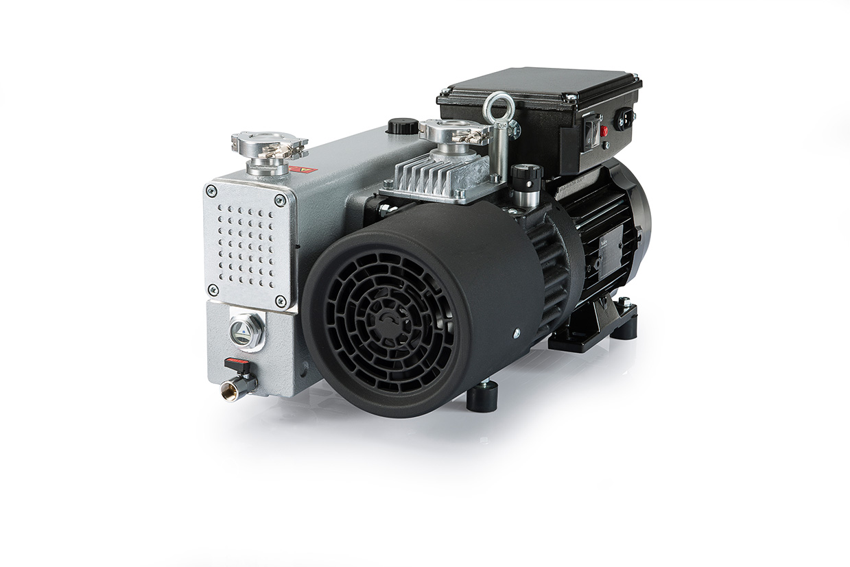

SOGEVAC NEO D - the emission-free rotary vane pump
Nowadays, modern vacuum technology must convince its users with emission-free, smooth running and sustainability. With these requirements in mind, Leybold has developed the compact SOGEVAC NEO D, an innovative 2-stage vacuum pump with integrated oil mist separator on the exhaust side. The working environment remains clean and free of oil mist during pumping. Continuous operation is possible without an external filter at any inlet pressure.
The robust SOGEVAC NEO D is optimized for applications requiring a pumping speed in the range of 1x10-2 to 1mbar; perfect for small heat treatment furnaces or as a holding pump for diffusion pumps. The SOGEVAC NEO D offers a stable process vacuum but is less expensive than conventional alternatives and saves up to ten percent energy due to its significantly smaller rotating mass. Additional energy savings can be achieved by operating the pump by means of speed control with a frequency converter.

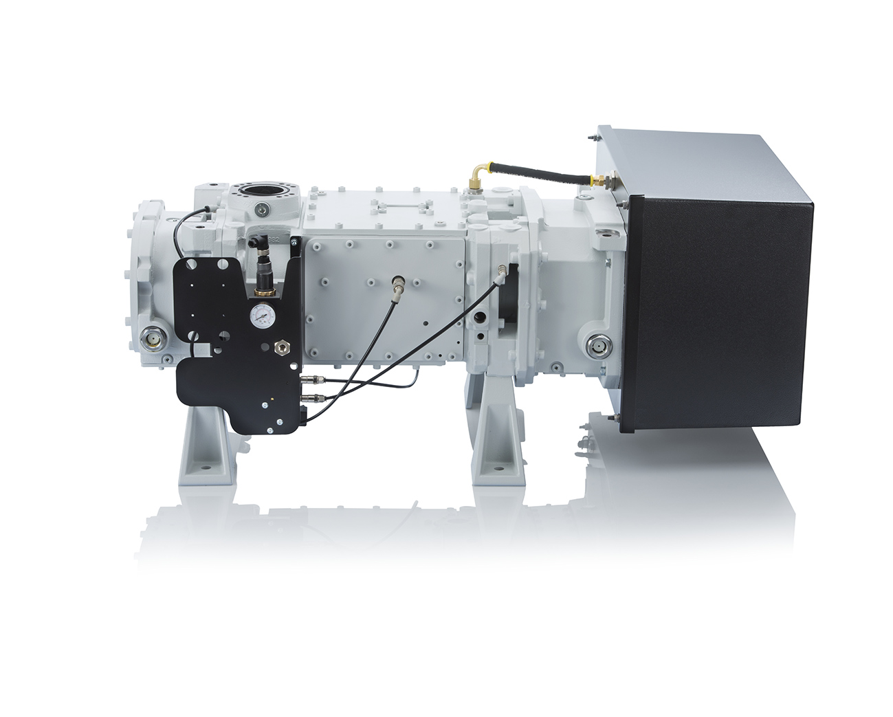

DRYVAC DV 200 and DV 300 - the innovative dry pumps
The dry-compressing screw vacuum pumps are designed for modern, intelligent production. They offer maximum energy efficiency, durability and future-proof network integration. Due to the optimized rotor geometry and the innovative motor design with efficiency class IE3, these pump types minimize power consumption and CO2 emissions. The bottom line is that DRYVAC pumps are cheaper and more environmentally friendly than comparable models.
The new compact DRYVAC models DV 200 and DV 300 are designed for harsh industrial applications, just as the larger pumps of the same pump series. They offer a long service life, even under demanding conditions with high humidity, dust or other process particles. DRYVAC pumps also require minimal maintenance.

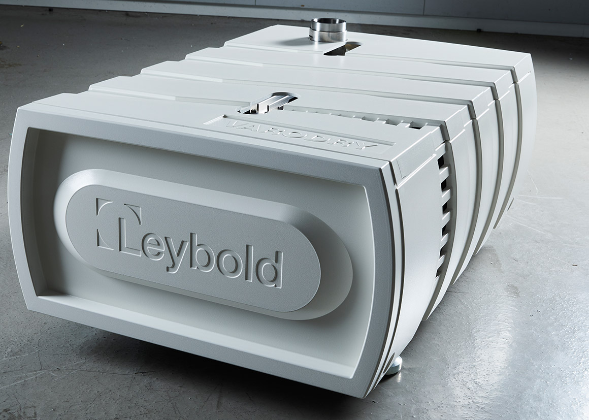

VARODRY - the 100% oil-free, dry-compressing screw pump
The 100% oil-free, dry-compressing and air-cooled VARODRY screw pump guarantees the required operating pressure and a short cycle time, especially in demanding processes. Thanks to its compact design and reduction to the essentials, the vacuum pump can be easily integrated into new or existing systems. Due to the integrated silencer, it is quiet and has a pleasant operational noise.
The air-cooled VARODRY is absolutely dry and clean. This prevents particle or oil migrations into the vacuum chamber or the environment. A further process advantage is their resilience and efficiency. It can be operated continuously at any inlet pressure and is completely resistant to regular shock ventilation. Therefore, any number of cycles can be run without overloading. VARODRY pumps ensures uninterrupted operation without system downtimes. This qualifies it as the ideal vacuum pump for heat treatment applications and metallurgical processes.

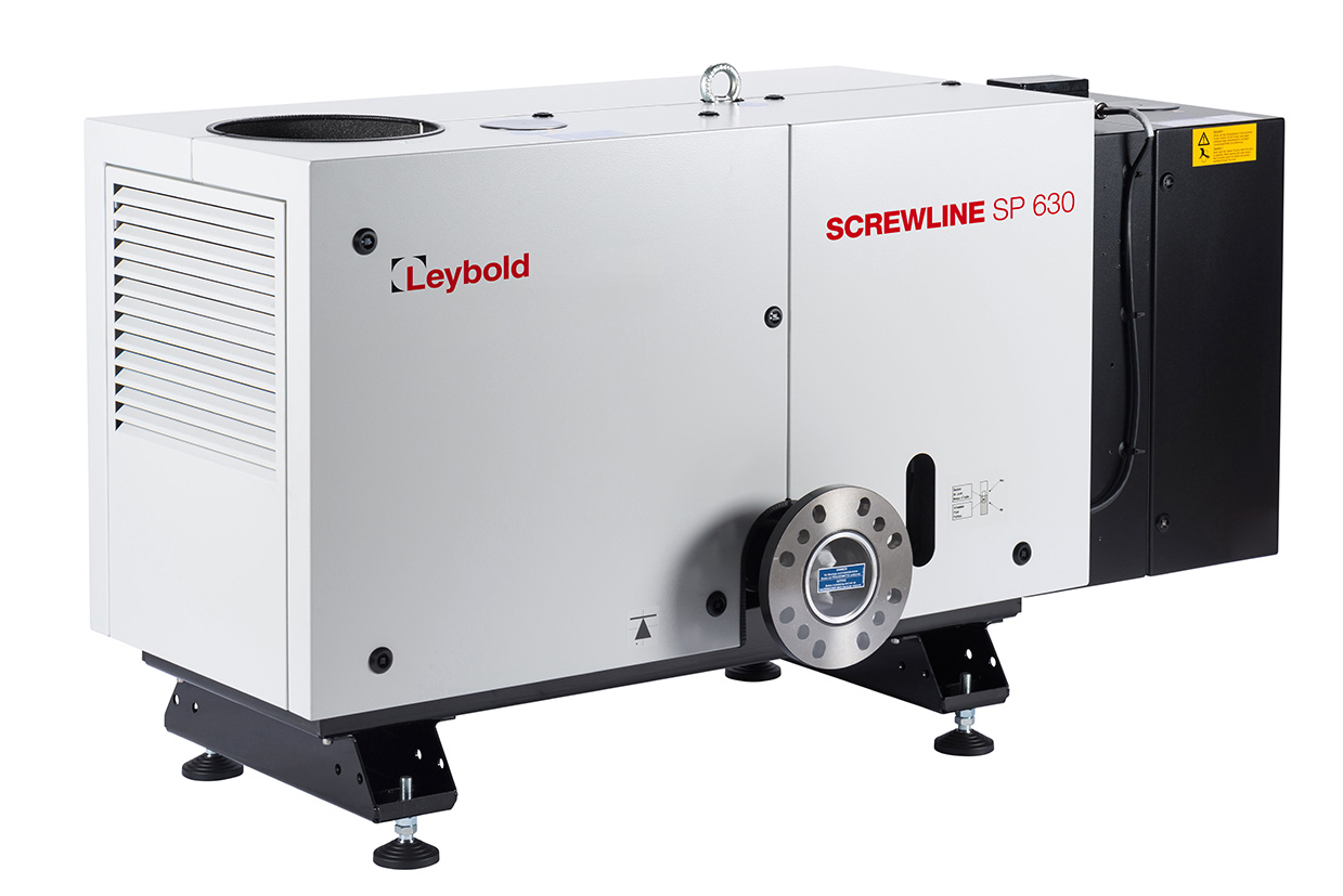

SCREWLINE - dry screw pump for extremely dirty applications
In demanding applications such as sintering or carburizing, dry-compressing screw pumps are preferred as backing pumps. They are more efficient and reliable than oil-sealed pumps. Especially the SCREWLINE pumps have proven themselves in extremely dirty applications. Their main advantage: The pump chamber of this pump family can easily be cleaned by the customer on site, for example during process pauses by means of flushing.

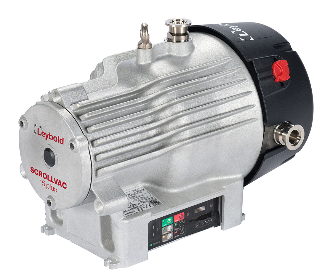

SCROLLVAC - low power consumption, high pumping speed
With the air-cooled, oil-free SCROLLVAC plus, Leybold offers an uncomplicated, reliable backing pump. Its properties predestine it for a wide range of demanding applications, such as laboratory vacuum furnaces. This is also due to the low power consumption of the backing pump combined with high pumping speed. In addition, the SCROLLVAC plus, with its lightweight, compact design, takes up very little space. This enables integration into new and existing vacuum systems.
Its functional and design features simplify daily handling of the backing pump. For example, the hermetic sealing of the rotating parts of the pump chamber reduces the risk of contamination. By dispensing with shaft seals that are susceptible to wear, developers have achieved higher integral tightness.

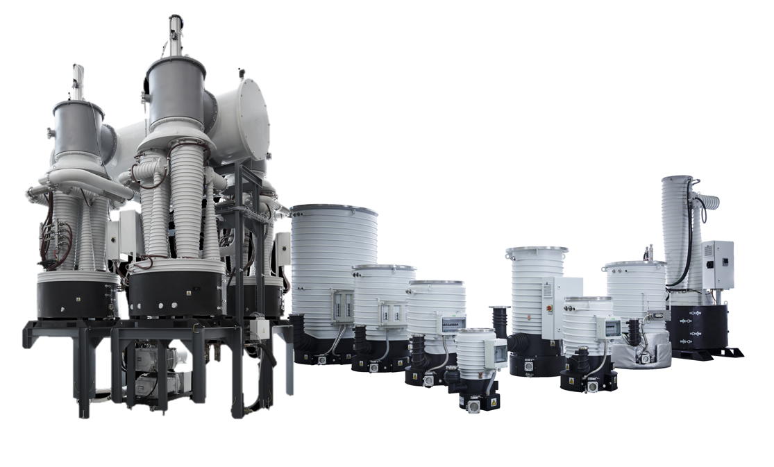

DIP - DIJ - OB - Oil-jet steam pumps and systems for high-vacuum processes
Oil steam jet pumps and systems are characterized by the highest pumping speeds in metallurgical industrial high-vacuum processes. These pumps are robust continuous-running pumps and have proven themselves in steel production processes such as VIM and VAR, or in high-vacuum industrial furnaces. The pumping effect of these ejector pumps is created through the diffusion of the gases that are pumped into the vapor jet. Compared to other high vacuum pumps, the pumping speed compared to the surface area is very high.
