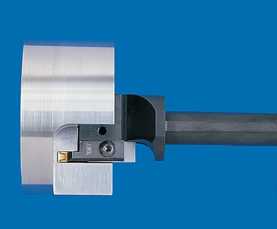

Kaiser Tool Co. has expanded its line of Thinbit Deepgroove support blade-style tools. The new tools cut internal face grooves with major diameters that start at 1.574" (39.980mm) and a DOC to 1" (25.4mm).
March 1, 2015
Kaiser Tool Co. has expanded its line of Thinbit Deepgroove support blade-style tools. The new tools cut internal face grooves with major diameters that start at 1.574" (39.980mm) and a DOC to 1" (25.4mm). The system uses modular cutting heads and clamps and can be reconfi gured for different major diameter ranges and insert sizes. Inserts are available in 2mm (0.079"), 3mm (0.118"), 4mm (0.157"), 5mm (0.197") and 6mm (0.236") sizes.
